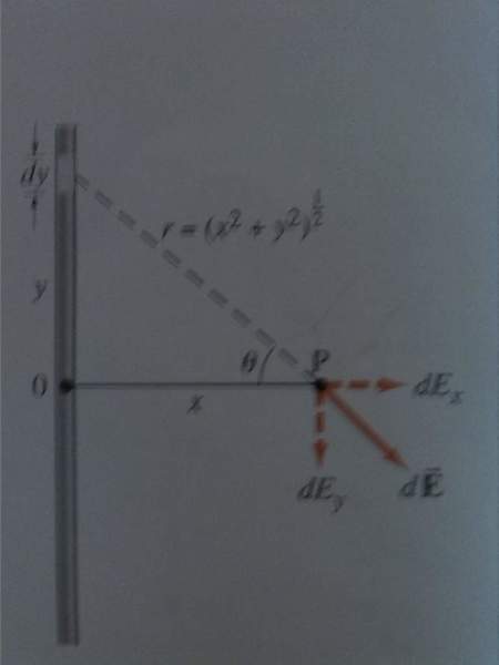

Well the main problem here its once a i get the integral i do not how to put dy as function of thetha and then integrate ; at the end that's what i get
Ex=integral (dE*cos[itex]\theta[/itex])=([itex]\lambda[/itex]/4[itex]\pi[/itex][itex]\epsilon[/itex])
times the integral of cos([itex]\theta[/itex])dy/x^2+y^2
where i can easily find the cosine and do the integral but I'm asked to express strictly "y" as function of thetha so as cos(θ)=x/√x^2+y^2 so 1/√x^2+y^2=cos^2(θ)/x^2
and i know that y=x*tan(θ) but i don't how to get "dy" graphically nor analytically;

Why not do the integral in terms of dy?
Well the professor asked us for bring both methods in terms of y as function of theta & theta as function of y;
I already did in terms of dy. making the substitution of cosine(θ) = x/√x^2+y^2 and then integrating.
but now i need the other method. y in terms of "θ"
OK - so complete: $$y=x\tan\theta\\ \implies \frac{dy}{d\theta}=\cdots$$ ... then multiply both sides by ##d\theta##.
Then substitute these values for y and dy into:
$$E_x=\frac{\lambda}{4\pi\epsilon_0}\int \frac{\cos\theta\; dy}{x^2+y^2}$$ ... with appropriate limits.
