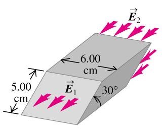

Electric Field: not quite getting the correct answer
The discussion revolves around calculating the electric flux for two uniform electric fields, E1 and E2, given their magnitudes and angles relative to the surface normal. The user attempts to compute the total flux using the formula flux = E * A * cos(θ) for both fields but finds their answer incorrect. It is clarified that both fields are at an angle of 60 degrees from the surface normal, which affects the cosine factor in the calculations. The user seeks assistance in identifying the error in their approach. Accurate calculations of electric flux are essential for determining the enclosed charge using Gauss's law.
Seraph404
63
E1 = 2.9E4 N/C
E2 = 8.6E4 N/C
Both fields are uniform
flux = \int Eperp*dA = Qencl/ \epsilon0
flux1 = E1cos(30)(.05m)(.06m)
flux2=E2cos(30)(.05m)(.06m)
(flux1+flux2) = Qencl/ \epsilon0
But my answer is wrong. I appreciate any help.
What is the question?
Also, those fields are at an angle of 60 degrees from the surface normal.
