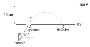

This is from the 2009 HSC exam. (I'm in Australia)
I checked the answers and found that electric field strength was
E = 100/0.10 = 1000
My question is, what would the electric field strength be if the positively charged plate was +100V instead of 0V
Would it be 200/0.1 = 2000?
Is the formula E = The difference in volts between the two plates / distance.
Please help this has been bugging me.

No it was not. The electric field strength is a dimensionful quantity and you simply cannot quote it as just a number without a unit. The field strength is 1000 V/m = 1 kV/m.
It would be 2000 V/m.

why would you think that ?
There isn't a 20V difference across the plates
one terminal of the battery, the positive, is +10V relative to the 0V of the negative terminalDave
