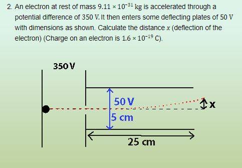

Hi Guys,
I have attempted the question below. Please have a look at my work and let me know if everything looks fine. Any feedback would be great.
1. Homework Statement
F = qv/d
a = F/m
t = d/v
qv = 1/2mv^2
x = vt + 1/2 at^2
