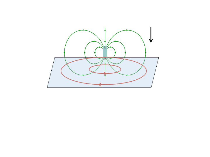

Yes, exactly. Think of dropping a magnet perfectly perpendicular to a copper plate. Why doesn't the plate experience a torque? The eddy currents heat up the conductor as the charges collide with impurities and ions. If we placed this plate on a very low friction surface; why wouldn't it be like spinning tires on ice?
phyzguy said:
I think you will find that in part of the copper plates the eddy currents will circulate in one direction, and in other parts they will circulate in the opposite direction, so no angular momentum is transferred.
Not if we drop a magnet with it's poles perpendicular to the surface of the copper plate.

I think you're wrong. Look at the attached diagram. The magnetic field lines from the magnet form closed loops. Inside some radius, the magnetic field lines are pointing upward, so as the magnet moves closer to the plate, [itex]\frac{\partial B}{\partial t}[/itex] has one sign. Further out, the magnetic field lines are pointing downward, so as the magnet moves closer to the plate, [itex]\frac{\partial B}{\partial t}[/itex] has the opposite sign. I think if you calculate it out you will find that the total angular momentum transfer integrates to zero.
Diagram of a bar magnet, labelled N at top and S at bottom, standing perpendicular to a light blue plate, with green magnetic field lines looping out of the north pole and back into the south pole, and red circular current loops drawn in the plate around the magnet, with a black arrow pointing downward at the upper right.
  • Diagram of a bar magnet, labelled N at top and S at bottom, standing perpendicular to a light blue plate, with green magnetic field lines looping out of the north pole and back into the south pole, and red circular current loops drawn in the plate around the magnet, with a black arrow pointing downward at the upper right.
The total net flux does not sum to zero for any finite size plate. (Consider a long solenoid and a plate the diameter of the solenoid)
If this is correct the outer current loops would accelerate the magnet towards the sheet of copper. Actually, no force would act on the magnet because the magnetic fields of the induced currents would cancel. We can use the right hand rule to find the direction of current flow. The flux lines that are facing down are also growing perpendicularly to the sheet and out from the magnet. If I use my right index finger in place of the black arrow; my thumb is the direction the magnetic field is growing. My middle finger points in the direction of the emf. In this case; the current will flow counter clockwise.

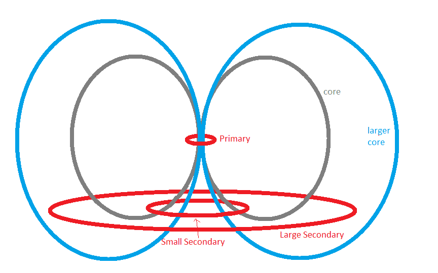

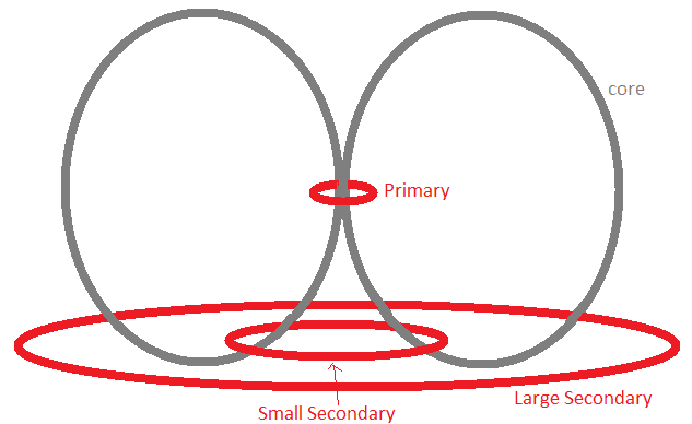

I really don't like this argument. I do like Faraday's concept of lines generally, but people take them too literally. They don't really exist. There aren't seven of them attached to this magnet, nor any other number of them. (*)You could draw a unique line through any point in space and for any two points in space, you could find a point, say, midway between them to get another line. Or you could not bother to draw any lines! The field would still be there.
Now in your diagram you get your effect, IMO, by being selective in which lines you choose to draw. Put another line outside your largest magnetic loop and that field links with the current ring in the correct manner. All your field lines do not link with the larger circuit and so do not induce any emf.
If you consider just that one magnetic line of force (the largest closed line you show) as being in a thin iron core of a transformer. (Grey)
The primary coil of the transformer wound round it in the position of the permanent magnet. (Red)
Two secondary coils positioned wher you show the two current loops. (Red)
Diagram of a grey two-loop core with a red primary coil at the centre joint, a small red secondary coil under the left loop and a large red secondary coil encircling the base. Labels read "core", "Primary", "Small Secondary" and "Large Secondary".
In which coil do you think an emf (and, since it's a conducting loop, a current) would be induced?
a) Both secondaries, in opposite directions
b) Both secondaries, in the same direction
c) In the smaller secondary coil, but not the larger
d) In the larger secondary coil, but not the smaller
e) In neither
f) (and just for good measure) None of the above
Then the same question if we used a larger "line" of magnetism as the core instead. (Blue)
Diagram of two overlapping grey loops labelled core and two larger blue loops labelled larger core, with a small red primary ring at the centre and two red secondary rings, small and large, below.
If we used both cores, would the induced emfs be in the same direction or in opposite directions? (Or any of the other combinations.)

  • Diagram of a grey two-loop core with a red primary coil at the centre joint, a small red secondary coil under the left loop and a large red secondary coil encircling the base. Labels read "core", "Primary", "Small Secondary" and "Large Secondary".
  • Diagram of two overlapping grey loops labelled core and two larger blue loops labelled larger core, with a small red primary ring at the centre and two red secondary rings, small and large, below.

When I asked the original question I assumed I understood the effect of a magnet moving towards a conductor. Now I'm not so sure. I always thought that the field lines can only be used when also identifying the direction the magnetic field is growing. In the diagram Phyzguy made; the down arrows aren't propagating towards the sheet. They are radiating perpendicularly out from the magnets center. That means all the eddy currents will flow in the same direction. Is this incorrect?
Rather than reply specifically, let me be sure we all understand the "field lines" picture. They represent a snapshot in time. The field vector is || to the line and its strength is proportional to the local density of lines. The flux of the field through a surface therefore can be estimated by counting (with arrows) the lines that pierce it. The B field lines are always loops (right handed or from N to S pole).
In our case then at each plane "-z" the total number of "up" and "down" lines are equal but the "up" lines concentrate at the S pole.
The circle at S pole has ~all up and no down lines. Successively larger circles include more and more down lines until at r=infinity there is no net flux. As the magnet moves away all flux totals diminish monotonically. So for all circles:

Looks like I muddied the waters with my comment.
I agree with hutchphd in his description of the effect of his bar magnet, but my intended correct answer was not b), because no flux from the transformer core links the larger circle.
I had sought to isolate a single "line" of flux from his diagram, to show the effect of that bit of the field.
Since we seem to agree, more or less, on the nature and significance of these lines, perhaps I should have been more explicit in the design of the transformer core.
