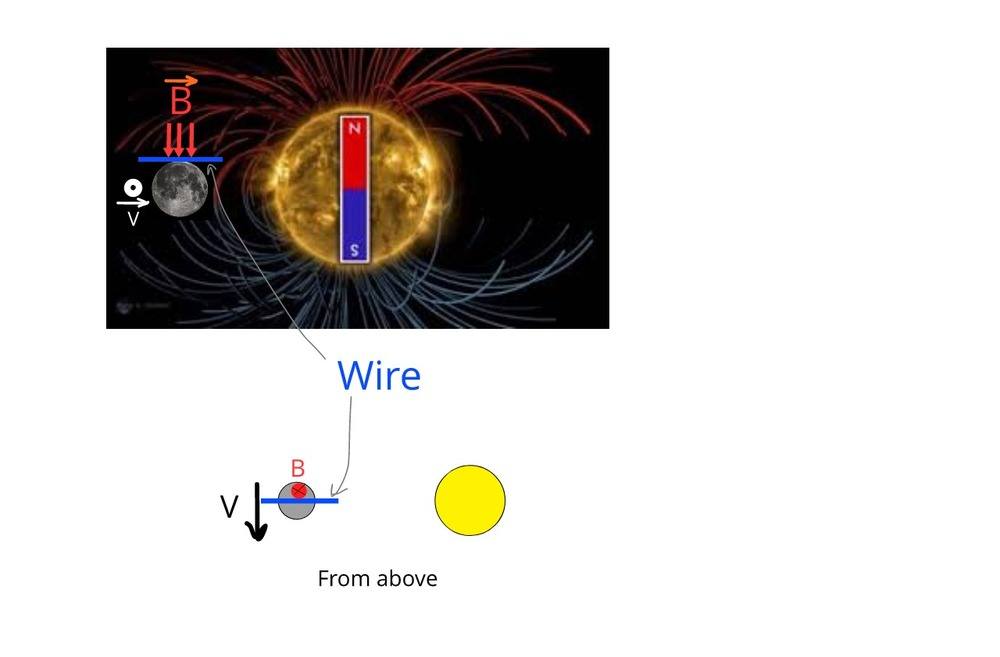

Moon and Mars have no magnetic field, but that they are immersed into solar magnetic field.
If I place a long wire along north pole, perpendicular to Sun, while Moon/Mars moves along its orbit, the wire cuts magnetic field lines; this should produce a difference of potential between fare edges of the wire... or not?
If I connect a second wire to first one, but I completely insulate it (how?) from solar magnetic field, would I get an electric generator?
Of course the DDP would change during day and year, until it reverses, but a diode could prevent current from flowing in wrong direction.

I think you completely misunderstood my post.
Forget Mars.
Just replace "Moon/Mars" by "Moon" in the post above.
Look at the picture:
Will electrons in the wire be moved along it by Lorentz force?
If I connect a second wire parallel to the first one, but completely isolated shielded from solar magnetic field, will I have a closed circuit containing a generator?

If I understand correctly, the Difference Of Potential in the tether is given by:
Voc = v * B * L
v = perpendicular tether speed across EM [m/s]
B = EM field [Tesla]
L = tether length [m]
And the current in the tether, disregarding the "ionosphere items", as we are on the Moon:
I = Voc / Rt
Rt = tether resistance
Hence:
I = v*B*L/Rt
But
Rt = rho * L / A
rho = resistivity
L = length
A = section area
hence:
I = v * B * A / rho (no more "L")
being:
A= 3.14 * r^2 [m^2]
rho = 1.68E-08 [Ohm*m]
I = 3.14/rho * v * B * r^2 = 1.86E08 * v * B * r^2
Orbit speed of Moon around Sun can be assumed as the same of Earth, 108000 km/h, i.e. ~30000 m/s:
v = 3E+04 [m/s]
Sun EM on Moon should be around 1E-09 [T] (confirmations?)
B = 1E-09 [T]
So:
I = 1.86E08 * 3E+04 * 1E-09 * r^2
I = 5.58E+03 * r^2
This is a weird result, as the final current would depend just on tether section and not on its length...
Is this result correct?
Assuming a 10mm radius tether (10^-2 m), we would get:
I = 5.58E+03 * 1E-4
I = 0.558 Ampere (regardless of length)
If it is true that tether length does not matter (and I can't see how it could), if I'd get a block of copper 1m x 1m x 1m, would it generate 5580A?!?
Be careful here. That is the velocity relative to the field. In the case of the Earth-moon system, the field moves with the objects, so if the tether was attached to the Earth-Moon, it would rotate with the field and the velocity relative to the field is zero.
To the SUN field, I am talking about Sun EMF.
