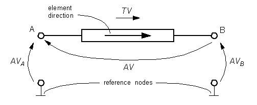

not sure i agree with you.
i was taught linear circuits from a generalized point of view, where you have across variables, and through variables. or as we would have called it at the time, linear network theory. (not to be confused with what most people would associate with networks now, computer networks). within this framework, you have elements that are sources (pretend there are only independent sources for now), and elements that are sinks. by convention, sources have positive across and through variables in the same direction, and on a sink, a positive through variable generates a positive across variable in the opposite direction. for linear electrical circuits, across variable is voltage, and through variable is current. this is conventional current. it is a consequence of a generalized version of a mathematical tool for analyzing linear networks.
now, it just so happened that the proton was assigned positive convention, and the electron negative, before this came about. if electrons had been labelled as positive, conventional current would be electron flow.
i couldn't find the across/through variable stuff on wikipedia (or rather i gave up while i was behind), but here's a couple of things to give you an idea of it.
http://www.mathworks.com/help/toolbox/physmod/simscape/ug/bq89sba-1.html#bq89sba-3
http://www.20sim.com/webhelp/modeling_tutorial/iconic_diagrams/acrossandthrough.htm
oh, and looks like google books let's you see it in one of Dorf's books
http://books.google.com/books?id=V-...ge&q=across variable through variable&f=false
i don't know, but I've been told, that the navy used to teach its techs electron flow. and that it made a lot more sense to do that when things ran on tubes.

Proton Soup said:
... but here's a couple of things to give you an idea of it.
http://www.mathworks.com/help/toolbox/physmod/simscape/ug/bq89sba-1.html#bq89sba-3 ...
I'm bookmarking this one.
Especially this part on "Direction of Variables":
...if an element is oriented from port A to port B, it implies that the Through variable (TV) is positive if it "flows" from A to B, and the Across variable is determined as AV = AVA – AVB, where AVA and AVB are the element node potentials or, in other words, the values of this Across variable at ports A and B, respectively.
I love it. Thanks.
