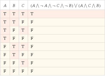

Am I close? (A* (A' * C ') * B ') + (A * C * B)
I also came up with some tables is this right?
  • Truth table with columns A, B, C and the expression (A ∧ ¬A ∧ ¬C ∧ ¬B) ∨ (A ∧ C ∧ B), eight rows of T and F values; only the first row, A, B, C all T, gives T.

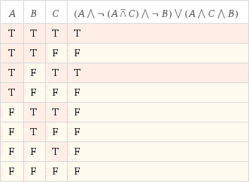

I think i mucked up circuit 1: its (A* (A' * C ')' * B ') + (A * C * B). Could someone tell me if I'm right?
  • Truth table with columns A, B, C and the output of (A ∧ ¬(A ⊼ C) ∧ ¬B) ∨ (A ∧ C ∧ B), eight rows of T and F values, with output T in rows 1, 3 and 4 is not correct; output is T only in rows 1 and 3.
Yes, that looks correct.
