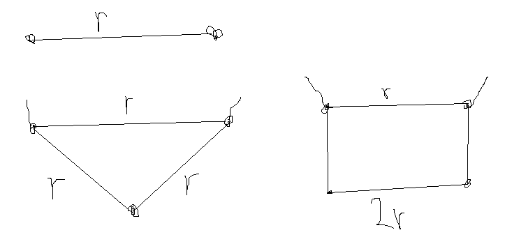

so i was thinking i could take a look at small number of points and then generalize it but my method soon breaks down

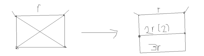

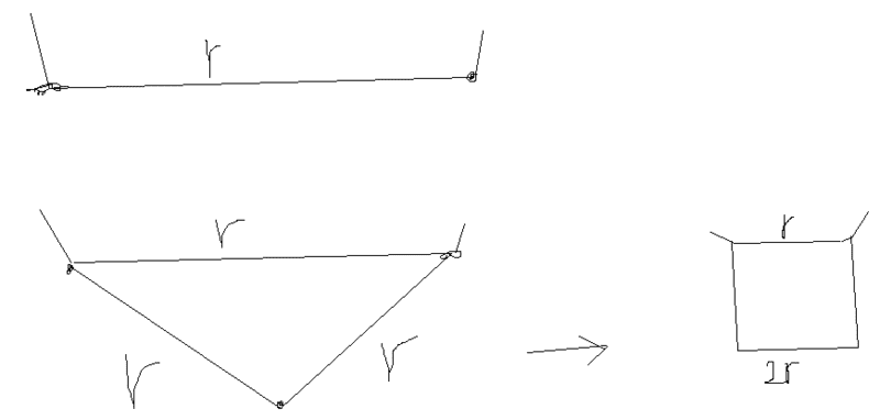

in the diagram i have denoted the resistance of the segment beside it if there is a bracket it means how many of such branches there are in parallel to it i tried to conjecture some kind of pattern right in the next one i ran into some problems..
well for the four point situation the one on the right shows what i believe would be the equivalent transformed circuit but

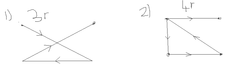

1)for the case 3r looking at it there is actually two paths which has 3r the other one being the one that goes along the diagonal first then left and then back to end point
2) there also seems to be a path of 4r
here is picture of what i mean
i know such paths are not possible(can someone verify this for me it is just a gut feeling ) for at some point the current is going in the opposite direction but i don't know how to make mathematical pattern that would reject such paths
i was thinking of maybe assigning an appropriate numbering system and then imposing restrictions like the numbers need to be arranged in a non decreasing order this is a wild guess but maybe something along that line

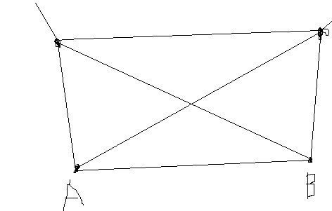

for 4 points how did you get r equivalent as R/2 i am getting as 3/7 R there is one R path two 2R path and one 3R path in parallel to one another
It will be better if you posted your diagram here.
Choose any two points between which you want to calculate the equivalent resistance. You'll notice a balanced Wheatstone bridge.
is it that there is no potential difference across A and B
  • #31
I assume that your two terminals are the nodes in the upper left and upper right. Yes, since there is no potential difference between A and B (by a symmetry argument), one can remove the direct connection between A and B without modifying the resistance of the network.
With that link removed, one can see that there are exactly three parallel paths. Two of length 2 and one of length 1.
Similarly for any number of nodes greater than 4. Since all of the intermediate nodes are at the same potential, one can remove all of their direct connections to one another without modifying the resistance of the network. One is left with n-1 parallel paths. n-2 of length 2 and one of length 1.
