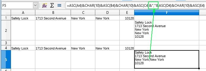

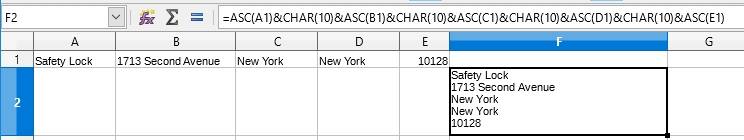

Another approach is to set up a cell to concatenate text contained in source columns like so.
Caveat: I'm using LibreOffice Calc; Excel formulas can be somewhat different.
In this example cells A1 through E1 contain elements of the postal address, and cell F2 contains the formula.
  • ASC(cell) returns the specified cell's text value.
  • & is used to tie individual text strings together.
  • CHAR(10) is the ASCII code value for LF (line feed/new line). This is what the Alt-Enter key combo does.
To separate "City" and "State" fields with a comma, substitute a comma for the appropriate line feed.
View attachment 215684To separate "City" and "State" fields with a comma, substitute a comma for the appropriate line feed.
Excellent, man, thanks!. I would even suggest a new subforum for Excel, given how many people use it , and how versatile it can be.
