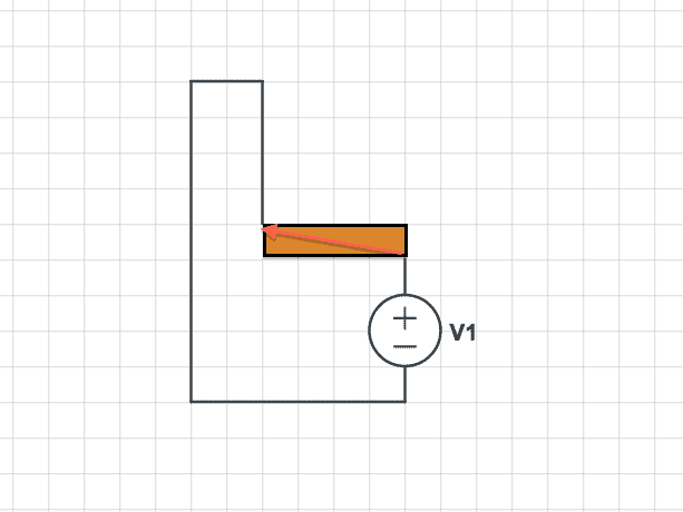

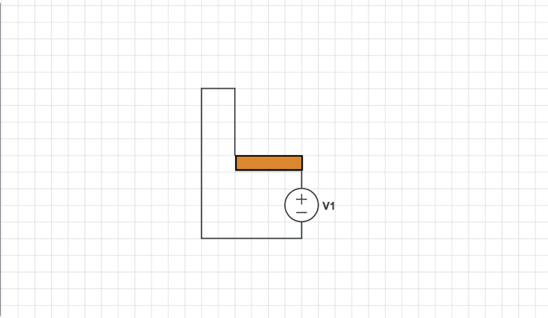

In the following diagrams:

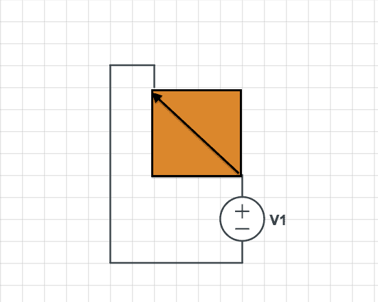

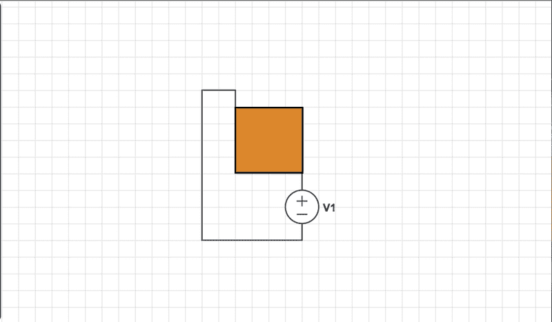

and:
Is current flowing horizontal or vertical&horizontal?
I'm sure for the rectangle one the flow of current is horizontal, but not sure of that square.
This "analogy"(?) doesn't tell me anything about current. If anything, it might suggest a higher potential in the second one.
In both of the diagrams the current flow is both vertical and horizontal.
Assuming the voltage source has a positive value, current will flow from the voltage source into the bottom right corner of the rectangle and then to the upper left corner of the rectangle, then back around to the source.
That being said, asking if the current flow is vertical or horizontal is a very strange question.
Why do you need to know this?

Why? It's quite simple, a voltage source connected to different shapes of conductors.
I wanted to know if they flow of current would be strictly horizontal on the first one, and both horizontal and vertical for the second.
To be exact, can the direction of current be assumed like so:
And:
Is it evenly divided, as to how some current flow vertical and some current flows horizontal(50/50)?

Wanted to see how the "shape" or dimensions of a conductor, and where it's connected had an effect on direction of current.
the current will flow throughout the conductor, not just in a narrow line across it
If that is a conductive medium of uniform thickness, then the current spreads out in a wide swayth, it doesn't confine its path to a thin middle strip. Think of the block as many resistances all in parallel; current goes through each, though proportionally less through the higher resistance (i.e., longer) paths.

It's like fluid flow. There'll be equipotential lines , segments of a circle centered on corners, with flow largely perpendicular

While the current does flow throughout all of the conductor, it will still flow from high to low voltage.
Therefore the general flow of current will be from the bottom right to the upper left.
You can also say that the equipotential lines, right next to the connectionswill be arcs of a circle. If the area is a square, (easy bit of symmetry) there will be a diagonal equipotential line across the 'other' diagonal. In the region of that diagonal, the lines will be spaced out more (lower voltage drop because of the lower effective parallel resistance) and tighter together near the connections. The shapes of the lines will morph as you move across the square.
I just can't remember the book work to do the analysis but the arm waving picture will look as I describe.
Oh yes - and the current will always flow at right angles to the equipotential lines.

Here's what the Equipotential Lines for three geometries look like that may help.

So --- using dlgoff's rightmost picture
let's think for a second about your sketch:
There'll be a minute voltage drop across any real (non-ideal) conductor.
Since current enters at lower right and exits upper left, there must be a tiny potential difference.
Draw a line made of red dashes between lower left and upper right vertices ...
Would that line represent locus of potential halfway between head and tail of your arrow?
Could your arrow represent the miniscule electric field that's moving charge ?
Would there be other electric field arrows surrounding yours, bent convex like the field lines in Don's rightmost sketch ?
Could you draw in dashed equipotential lines perpendicular to the field lines?
Could you go back to 8th grade geometry and figure out their loci? Seems to me they'd be segments of circles with centers lying on extensions of your arrow .

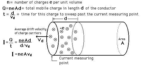

Drift velocity does imply direction so there is an implication of vector there. Having looked at those other learned threads, I think the answer is that it is and it isn't a vector - depending upon what sort of vector you're talking about. The path of charges on a conductor of changing width can't be the same all over the csa of the conductor (obvious) and if you take a small element somewhere, the charges will be moving in a different direction from at other places. So you don't need to constrain the current along an ideal wire for a Magnitude and Direction to be associated with the current. But, as 'they' say, you can't do simple vector addition to current so it has to be a 'special' kind of vector. I guess it's all to do with Flux and Area Vectors. We could probably leave it at that - unless we both / all want to do a lot more homework on Vectors and Vector Fields so that we' know what we're talking about. (And we'd hate not to, would't we?)
An electric current always refers to a surface and is the amount of electric charge, ##\mathrm{d} Q##, running through the surface in a small time interval ##\mathrm{d} t## devided by ##\mathrm{d} t##. So it's a scalar quantity, because charge and time are scalars.
The electric current density is much more intuitive, because it's a vector and given by the density of charge times the velocity of the charges, ##\vec{j}=\rho \vec{v}##. Now if you have a surface ##F## you can divide it into small area elements and assign area-element vectors to them. The vector has a magnitude given by the area of the area element and is directed perpendicular to the surface. It's your choice, which of the two possible orientations you choose. Then
##I=\int_{F} \mathrm{d}^2 \vec{F} \cdot \vec{j}##
is the current as defined above. It's a scalar, because the dot product of two vectors is a scalar, and an integral can be seen as the limit of a sum, and the sum of scalars is still a scalar.
To understand the above formula, it should be clear that in a time ##\mathrm{d} t## the charges contained in the volume ##\mathrm{d} V=\mathrm{d} t \vec{v} \cdot \mathrm{d}^2 \vec{F}## are streaming through the surface, and with the density the corresponding charge contained in that volume is ##\rho \mathrm{d} V=\mathrm{d} t \rho \vec{v} \cdot \mathrm{d}^2 \vec{F}=\mathrm{d} t \vec{j} \cdot \mathrm{d} \vec{F}##.
I hope that helps to clarify the physicists' convention to name the quantities "electric current" (scalar) and "electric current density" (vector).
