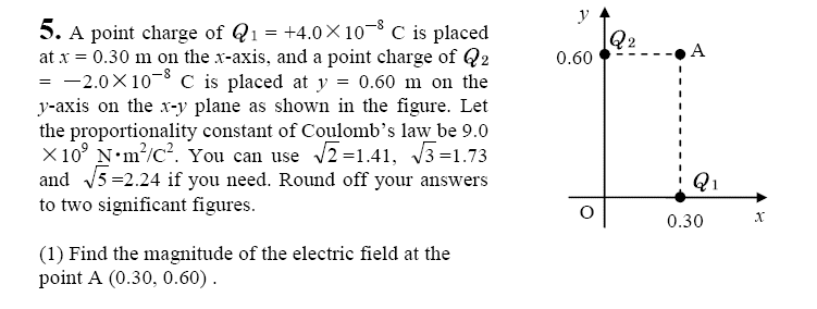

I've been learning electric field, and i want to ask about this question.EF net = EF1 + EF2
my EF1 = 9 x 109 * 4 x 10-8 / (0.6)2 = 1 x 103 (From Q1)
EF2 = 9 x 109 * 2 x 10-8 / (0.3)2 = 2 x 103 (From Q2)
then EFnet = (2+1) x 103 = 3 x 103
and what i get from key answer is 2.2 x 103
and anyone can tell me what i miss ?
The electric field is a vector quantity. What is its (vector) value at A?
Enet = (E12 + E22)1/2
Enet = 2.23 x 103
do you mean like that bro ? anything wrong from my answer ?
then for another question like this( at different point), just do this step ?
FJay said:
Enet = (E1E22 + E22)1/2
Enet = 2.23 x 103
There is a typo in the first equation, but otherwise this is correct.
Yes. You first calculate the electric field itself, as a vector, and then calculate the magnitude of the vector to get the magnitude of the field.
Thank you for your help.
