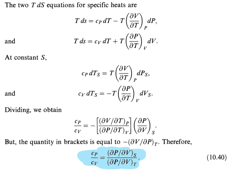

Can anyone guide me how can I find ##C_P## and ##C_V##?

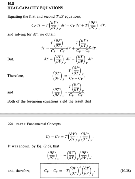

There are two equations in my book which I think can help but I'm not sure if I can use them to find ##C_P## and ##C_V## of a vander waals gas.

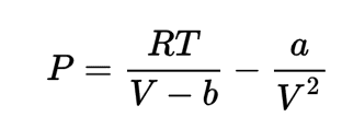

I know equation of state of this gas.
From first equation I find out that : $$C_P-C_V = \dfrac {R}{1 - \dfrac {2a(V-b)^2}{RTV^3}}$$
But I am not sure if I can use 2nd equation to find another relation between these to ...
I've checked some books but I didn't find anything about heat capacities of Van der Waals gas. Does anyone knows a book or a source that discuss this thing ?
You cannot calculate
$$\beta=\left(\frac{\partial P}{\partial V}\right)_S$$
because you do not have enough information about ##S##, the equation of state does not suffice here.
Imagine that you have ##PV=nRT## instead, how do you calculate ##\beta##? Well, you can't.

As you mentioned the professor told that I cannot use those equations to find thermal capacities ...I've checked many books but I did not find anything about thermal capacity of a Van der Waals gas. Does anyone know an article or source related to this topic? Thanks.
My current idea:
Find internal energy of Van der Waals gas:
$$dU= \frac {\partial U} {\partial T}dT + \frac {\partial U} {\partial V}dV$$$$U(T,V)=\int C_V dT-\dfrac {n^2a}{V}$$
Then finding heat capacities using: $$C_V= \frac {\partial U} {\partial T}$$$$C_P= C_V + ([\frac {\partial U} {\partial V}]_T +P)[\frac {\partial V} {\partial T}]_P$$
The problem us that it gives ##C_V=C_V## and ##C_P=C_V + sth## and it doesn't help.
