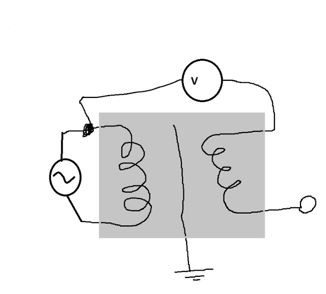

Hand-drawn transformer circuit: AC source on the left feeds the primary coil, a voltmeter labelled V is connected across the two windings, and the secondary coil ends in an open terminal on the right; the grey core is grounded below.
Hi, Just made a small thought experiment on the train, haven't really thought about it in depth. I was just wondering, if I created the above scenario (open circuit secondary and a voltmeter), would I get a voltage (assuming there is a difference in turns for primary and secondary)? Neglecting like capacitive or inductive coupling.
I have a feeling not, because both sides are isolated. (?)
And if so, could this be used to tell me something about the turns ratio or it's error?
Presumably if there was a voltage, both sides of the TX would be in-phase. But, please remind me, if the sides were slightly out of phase, that would be from the resistance in the primary and secondary coils?
So say the phase of the secondary was a bit out from that of the input, what would that mean to the 'class' of the transformer?
Also, would you then need like a bridge to feed in the primary and secondary to see the phase error of the TX?
Or what if the turns ratio is like N decimal point something? (not exactly just N) what does that mean for the TX 'class'?
Thanks

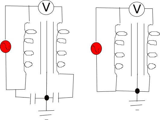

I think you are right, that you should get no reading in rhe absence of capacitative coupling. (If it's supposed to be a transformer, I think there must be some inductive coupling.)
And in reality I think you would get a reading, because there is likely to be some capacitative connection. (Left hand diagram)
I would simply make the connections in the right hand diagram. If you don't, any reading you get will be affected by the unknown capacitances as well as the turns ratio.
Depending on which way round the windings are, you should get the sum or difference of the voltages, which are proportional to the turns.
You could simply connect your voltmeter across each winding in turn, then get the actual voltages and be able to calculate the turns ratio directly.
Two circuit schematics of a transformer test setup, each with a red AC source on the left, a voltmeter V across the top, a central core with coil windings and a grounded node at the bottom.
Edit: Sorry I missed the last bits. IMO there should never be any phase error if the same flux links both coils. This is the aim. Since in reality the flux linkage will not be perfect, there certainly can be a magnitude error. I struggle to see how flux is changing direction (magnitude and sense are changing) in a transformer like this, but it must be possible, since it happens in a polyphase transformer. If parts of the core are more lossy than others, I suppose you could get a shaded pole effect.
I don't know how you could see this phase error without looking at the voltages on an oscilloscope or using some sort of phase sensitive meter.
I don't know what bridge you have in mind and I don't know a standard method for doing this, but it should be possible to compare two signals with varying attenuation and varying phase shift network to calculate the phase difference.

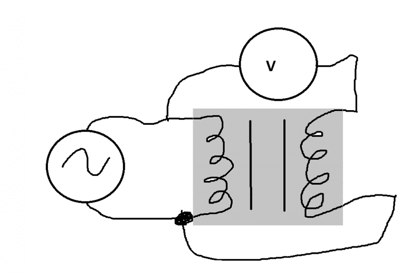

I finally got a chance to go through my notes (which aren't very detailed) and I saw (exactly like your LHS drawing, Merlin) a scribbled drawing of something like this:
Hand-drawn circuit diagram: an AC source with a sine wave symbol on the left feeds the primary winding of a transformer shown as a grey box with two core lines; a voltmeter marked V is connected across the secondary winding at the top right.
Now I'm not sure if it was an isolation TX or one with a turns ratio, but I think I was trying to find the ratio error of the turns ratio. Do you think this would tell you the ratio error of an isolation TX? (Or if you had a step-up VT with a turns ratio of 5 and you put 100V in, the voltmeter should read 400V? But in that case it would be easier to just measure input and output and divide them to calculate the ratio error? *as you said Merlin*)

If you were testing a 1:1 isolation TX as you suggest, I'd expect you to get either double the voltage or zero depending which way round you connected them. So perhaps this would be a sensitive test of matching, when they were corrected in the null sense.
