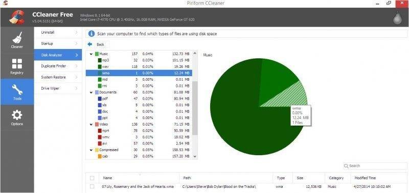

Well, it seems CCleaner might do that ... but I'm probably over my head, here... :olduhh:
Probably enough screen grabs, too... :oldeyes:
