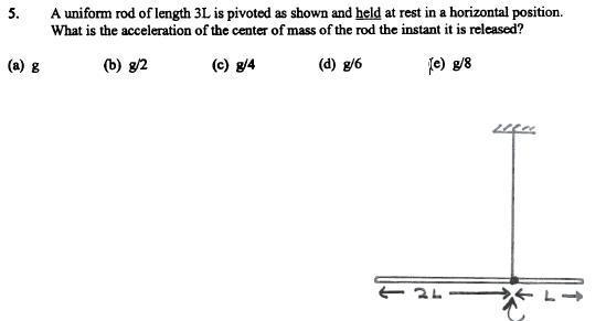

A uniform rod of length 3L is pivoted as shown and is resting at a horizontal position.
What is the acceleration of the center of mass of the rod the instant it is released?
The diagram is added to the attachment.
tnet=Iaangular
From parallel axis theorem the moment of inertia I, around the rotation axis is I=(1/12)mL2 + m(L/2)2=(1/3)mL2
tnet= mg(L/2) = Iaangular
mg(L/2)=(1/3)mL2(alinear/0.5L) as the centre of mass is 0.5m away from rotation axis.
mg/2=(2/3)malinear
g/2=(2/3)alinear
(3/4)g =alinear
Thats not the answer, where did i go wrong?

Hi Macroer! :smile:
erm :redface: … wrong L !
(1/12 of 3L squared)
Thanks! I would have never found that. :smile:
