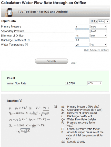

I have a basic question for my own understanding of things,
Consider a straight horizontal piece of Ø15 mm pipe (inside), 20 meters in length, with 5 bars static pressure connected to a water main. Trying to find out what the flow rate through the open end of the pipe will be, doesn't seem to be a straight forward operation. The flow rate depends on the head loss, which again depends on the flow rate. So how do I go about estimating the flow rate through the open end?
For a start, I would treat it as an orifice flow problem:
  • Given an orifice geometry (and therefore a discharge coefficient) and pressure you can calculate a flow rate.
  • Given this initial flow rate you can re-calculate for head loss in the length of pipe and then re-calculate your orifice flow given the slightly reduced pressure at the end of the pipe
  • Iterate towards a solution which balances the pipe's head loss for a particular flow rate, and the flow rate out the end of the pipe.
It looks like ballpark you're looking at about 12.5 m^3/hr. See here: http://www.tlv.com/global/TI/calculator/water-flow-rate-through-orifice.html

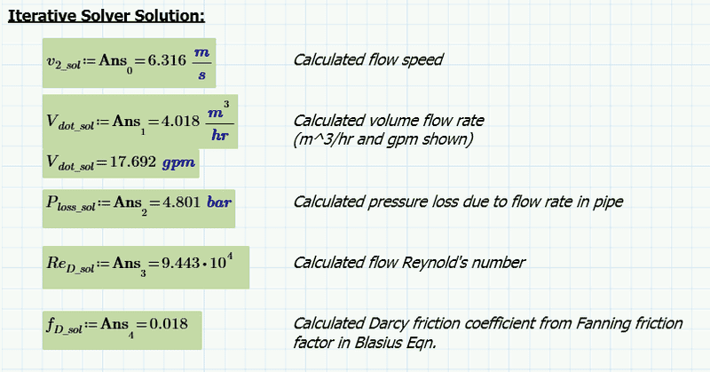

Like I said, the two calculations are equivalent. I'm going to redo the calculation with the Moody chart to compare directly. Why don't you try it with the fanning equation (this is what we ChEs use) to see what you get?
Using the Moody chart:
For 4.11 m^3/hr, I get a velocity of 6.46 m/s, and a Reynolds number of 96900 (using 1 centipoise for the viscosity of water at 20 C). At this Reynolds number, for a smooth pipe, I get a Moody friction factor of 0.018 from the Moody chart. The pressure drop is then:
$$\Delta P=\left(\frac{1}{2}\rho v^2\right)f\frac{L}{D}=\left(\frac{1}{2}(1.0)(626)^2\right)(0.018)\frac{2000}{1.5}=5.16\times 10^6\ dynes/cm^2=5.16\ bars$$

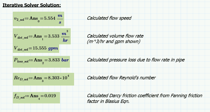

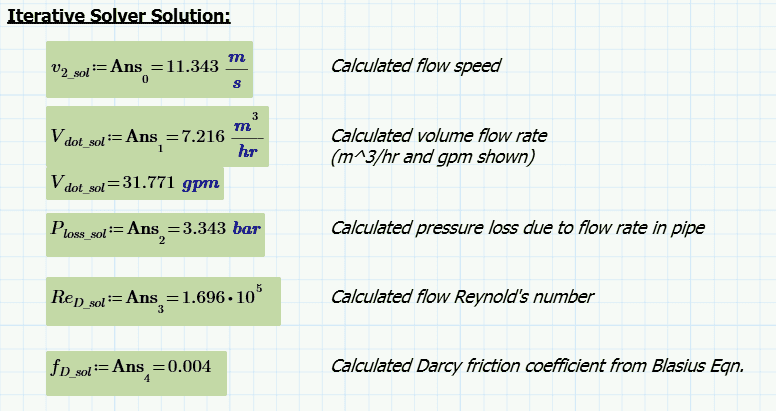

So I'm still kind of curious about this problem, not sure we've come to a consensus yet. I thought I might take another stab at it and see what other mistakes I can make ;-)

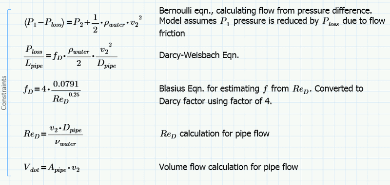

I created a new solution sheet where I tried implementing a numerical solver of multiple equations with multiple unknowns. I used the following equations in that solver:
Note: Error in these equations, see this post for updated set.
The solver came up with this solution:
The solution seems high to me based on the other numbers that have come up thus far, so what mistake did I make in the above equations? I did notice that the resultant friction coefficient is a bit higher than valid for the Blasius Equation Chester provided, but maybe I missed a number somewhere that would bring it down?

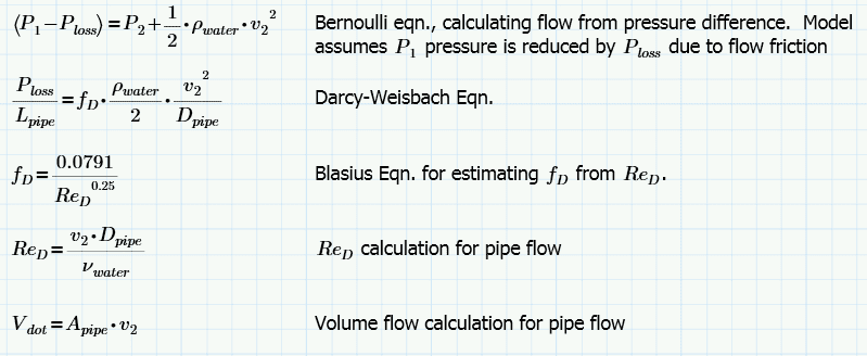

You're missing a factor of 4 in the pressure loss equation.
You mean in the Darcy-Weisbach equation, or one of the other ones?
Well the Darcy friction factor is 4x the fanning friction factor, so you decide.
