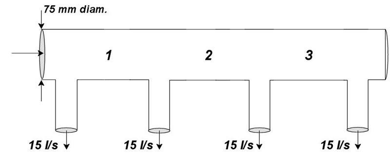

I'm looking for a formula that has velocity at a certain point in a pipe. I only have velocity and pipe diameter.
The problem goes something like:
A Tube with a 0.075 meter diameter has four drains equally spaced apart
with a cap at the far end. Each of the four drain opening has a flow of
15 L/s.
I need to find the average Vs in the tube between each of the drains, I marked them as 1, 2, and 3. If the flow is laminar, what are the max velocities at 1, 2, and 3? List assumptions needed for solving.
I'm still missing a relevant formula...
To start of I think that three boundary systems would need to be used:
System 1:
Inlet
Drain 1
Location 1
System 2:
Drain 2
Location 2
System 3:
Drain 3
Location 3
Drain 4
I worked on the problem a bit more:
I found the pipe area
A= 0.785 * Diameter2
=4415.625mm2
and Q or liquid flow rate = Rho * V * Area
so in order for the first velocity at the drain to be 15l/s, the Q must be at least 66.27 l/s
I'm still pretty stuck though and not sure if I'm going in the right direction
to find the entrance flow rate you have to do continuity, so pVa=4(pVa)
