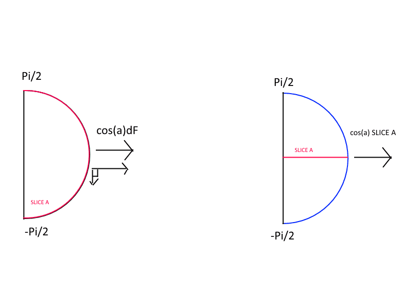

I have a basic understanding of integrals but I'm really bad at applying them to this stuff. Looking at the hemisphere from the side, if the flat part of the hemisphere goes along the y-axis I thought of taking a slice of the hemisphere then integrate over -π/2 to π/2 with cosine to get the total horizontal force of that slice. Then looking at the hemisphere from above, integrate that slice over -π/2 to π/2 with cosine to get the total horizontal force of all slices. I added an image to show my thoughts. Is this correct? And if so, could you show me how to integrate this?
Edit: Left hemisphere is seen from the side, right is seen from above

Hi Elias.
You quote shows a misunderstanding. This projection requires that the partitioning of the hemisphere into small dA pieces will project along he x-axis to exactly fill up the circle with the projected pieced. Not all surface shapes will do this.It is possible to create a shape so that different dA pieces will project onto the same part of the circle. The spherical shape can be integrated simply to show the same circle area as a result. It will also work for an ellipsoid where he x-axis is one of the symmetry axes.
Regarding the diagram, I am not sure I understand what you are showing. It would help if the diagram shows what happens to a dA piece, and you also provide text to explain what the diagram is intended to show,
Regards,
Buzz

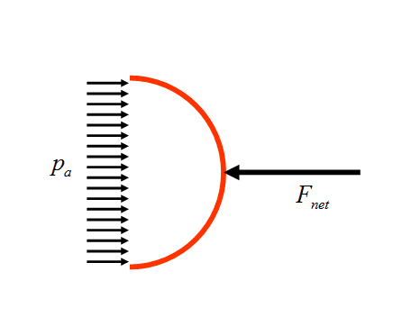

If you do a free body diagram on a hemisphere (and the air inside it) before the vacuum is applied, and write down the force balance on this combined system, you get $$p_a A_{rim}+p_a \frac{\pi D^2}{4}=F_{net}$$where ##p_a## is atmospheric pressure, ##A_{rim}## is the cross sectional area of the rim, D is the diameter of the cavity, and ##F_{net}## is the net resultant force of the air on the outside of the hemisphere.
When you apply vacuum to the inside of the joined hemispheres, the net force of the atmospheric air on the outside of each hemisphere doesn't change. So, it is still ##p_a \left(A_{rim}+\frac{\pi D^2}{4}\right)##
