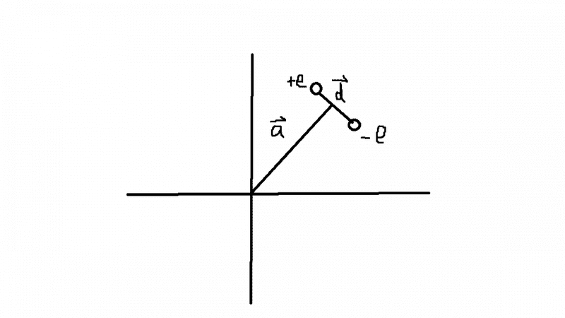

A dipole of moment ##\vec{p}## where p is fixed, moves with velocity ##\vec{v}## though a magnetic field ##\vec{B}##. Show that the force on the dipole is ##\vec{v}\times(\vec{p}\cdot\vec{\nabla})\vec{B}+\dot{\vec{p}}\times\vec{B}##.
##\vec{F}=e(\vec{E}+\vec{v}\times\vec{B})##
This is how I am picturing the situation:
##\vec{F}=\sum_i\vec{F_i}##
##~~~=e\vec{v}\times\vec{B_1}-e\vec{v}\times\vec{B_2}##
##~~~=e\vec{v}\times\vec{B}(\vec{a}+\frac{1}{2}\vec{d})-e\vec{v}\times\vec{B}(\vec{a}-\frac{1}{2}\vec{d})##, Now I taylor expand ##\vec{B}## and disregard high order terms:
##~~~\approx e\vec{v}\times[\vec{B}(\vec{a})+\frac{1}{2}\vec{d}\cdot\vec{\nabla}\vec{B}|_{\vec{a}}]-e\vec{v}\times[\vec{B}(\vec{a})-\frac{1}{2}\vec{d}\cdot\vec{\nabla}\vec{B}|_{\vec{a}}]##
##~~~=e\vec{v}\times\vec{B}(\vec{a})+\frac{1}{2}e\vec{v}\times(\vec{d}\cdot\vec{\nabla}\vec{B}|_{\vec{a}})-e\vec{v}\times\vec{B}(\vec{a})+\frac{1}{2}e\vec{v}\times(\vec{d}\cdot\vec{\nabla}\vec{B}|_{\vec{a}})##
##~~~=e\vec{v}\times(\vec{d}\cdot\vec{\nabla}\vec{B}|_{\vec{a}})##
##~~~=\vec{v}\times(\vec{p}\cdot\vec{\nabla}\vec{B}|_{\vec{a}})##
Using the identity ##\vec{\nabla}\times(\phi\vec{B})=(\vec{\nabla}\phi)\times\vec{B}+\phi\vec{\nabla}\times\vec{B}## and replacing ##\vec{\nabla}## with ##\vec{v}##, also replacing ##\phi## with ##(\vec{p}\cdot\vec{\nabla})## we get:
##~~~=\vec{v}(\vec{p}\cdot\vec{\nabla})\times\vec{B}+(\vec{p}\cdot\vec{\nabla})\vec{v}\times\vec{B}##
##~~~=\vec{v}\times (\vec{p}\cdot\vec{\nabla})\vec{B}+(\vec{p}\cdot\vec{\nabla})\vec{v}\times\vec{B}##
I think the above derivation is correct so far, so all that remains is to show that ##(\vec{p}\cdot\vec{\nabla})\vec{v}\equiv \dot{\vec{p}}## But I am stuck with this, any help will be appreciated.

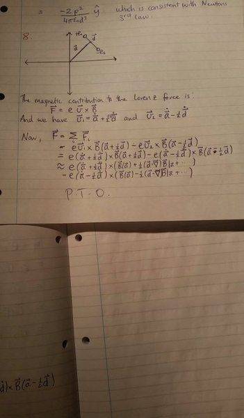

I tried thinking of the dipole as two charges, so a rotation of the dipole looks like two parallel currents in the same direction. When the dipole is aligned with the magnetic field, I can see that this produces a net force; but when the dipole, the field, and the rotation vector of the dipole are mutually orthogonal the two currents are aligned with the field, so I don't see why there is a force.
I think you should let each charge have its own velocity: ## \vec{v_1}## and ##\vec{v_2}##.
Shouldn't ##\vec{B}(\vec{a}+\frac{1}{2}\vec{d}) = \vec{B}(\vec{a}) + \frac{1}{2} ( \vec{d}\cdot\vec{\nabla} ) \vec{B}|_{\vec{a}}##? (with parentheses)

Ok and then would it be the case that ##\vec{v_1}=-\vec{v_2}## ?
No. Their sum is related to ##\dot{\vec{a}}##.
Yeah that should be the case, but does this change my answer (prior to the last two lines)?
I don't think you need to invoke the vector identity that you used in the first post. Yes, you should get your final result plus a term that comes from the particles having different velocities.
haruspex said:
Anyway, since TSny has joined the thread you are in much more capable hands, so I shall bow out.
Please don't. Excuse my jumping in. :redface:
I just happened to find that the result follows once you assign different velocities to the two particles.
I'm probably doing something wrong since I get the stated result without assuming that ##|\vec{p}|## is fixed. I'll need to check over my work.
Ok I think I have got it. Please excuse my laziness but I would prefer not typesetting it and just posting a picture.
That looks good. Note that the condition "p is fixed" is not used.
