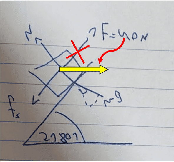

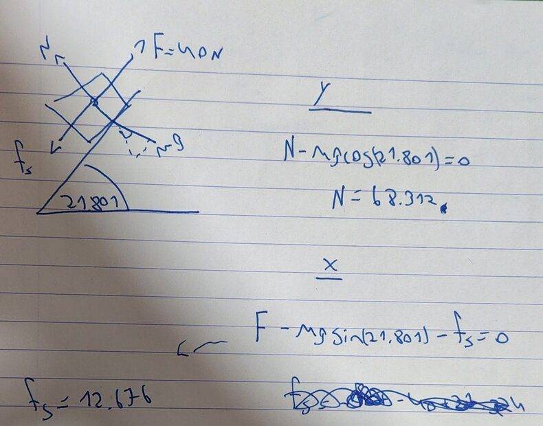

hey I am really hope for some help because i don't know what I am doing wrong, the angle of the first part is 21.801.
here is my solution i would like to know what I am doing wrong
Handwritten free-body diagram of a block on a ramp at 21.801 degrees, with normal force N, applied force F = 40N, friction f_s, and weight mg, followed by y-direction equation N - mg cos(21.801) = 0 giving N = 68.312, and x-direction equation F - mg sin(21.801) - f_s = 0 with f_s = 12.676.
You show force F directed up the incline. The problem says it is horizontal, parallel to the surface of the Earth. That should change your solution, no?
i understand but i don't know how to draw the force In this direction

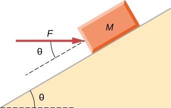

Free-body style diagram of a block labelled M on an incline at angle θ, with a horizontal force F pushing it toward the slope, and a dashed reference line making angle θ with F.

kuruman said:
i don't know why but it still wrong i disassembled F into components:
x - Fcos(21.801)
y- Fsin(21.801) - doesn't matter actually
and than i did
Fcos(21.801)-mgsin(21.801)-Fs=0
Fs=9.814N
and its wrong i would like to know what i did wrong
Your method is correct and agrees with my calculation. Is this the kind of problem that is scored by a machine on a website? If so, I see three four possibilities in order of likelihood: (a) you did not read the problem carefully enough (it happens to the best of us); (b) the angle of the incline is not 21.8°; (c) if 21.8° has already been marked as "correct" but is actually borderline within the tolerance of the scoring algorithm, then you might have roundoff errors that pushed the solution to the second part outside the algorithm's tolerance; (d) the algorithm uses the wrong formula to do its job; .
My recommendation is to redo the first part and make sure you avoid all roundoffs. If the angle is still 21.801°, show your solution to your instructor and ask for an explanation.
Edited to incorporate @haruspex's observation in post #12.

yesmale4 said:
Fs=9.814N
"Define your coordinate system such that your answer is positive if ##\vec f_s## is directed up the plane, and negative if ##\vec f_s## is directed down the plane."
Aaah! I missed that.
So because i put Fs down the plane the correct answer should be -9.814N ?
