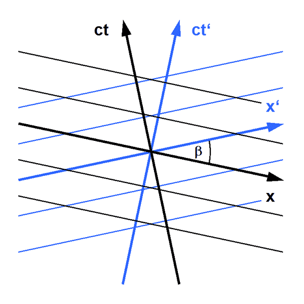

In this Minowski diagram, the thin blue lines show the blue S' frame's simultaneity planes. The thin black lines show the black S frame's simultaneity planes.
In a Minowski diagram, the usual rules of coordinates apply. If you have x'=3 at t=t'=0 and want to find the location of x'=3 in S at time t', you simply translate the point (3,0)' along the t' axis. In this sense, the simultaneity planes are copies of the spatial coordinate plane, or at least a temporal extension, however you want to define it.
We could describe lines, planes and hypersurfaces of simultaneity as (loosely speaking) subspaces of frames of reference.
Thanks for the diagram

I think espen's diagram says it all - but notice that on the lines and planes he's drawn no *numbers* are attached. Coordinate systems typically involve actually assigning numbers to events, but since this obviously involves nothing more than pure conventional choice of unit, we tend to forget about this.
I prefer to think of splitting up spacetime into a sequence of simultaneity (hyper)planes, rather than thinking of this as a single plane which `moves' through an observer's time - we can treat Newtonian space time as a sequence of copies of the very same plane at different times, because there's an absolute notion of sameness at place at different times, i.e absolute rest, in his theory. But provided we don't push the heuristic too far, and we understand there's no true identity, we can talk of various planes at different times as another way of thinking about the sequence of simultaneity planes.
