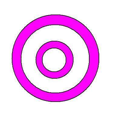

That equation physically means that if in the interface between two media there is surface charge density ##\sigma##, the electric field components perpendicular to this interface in the two media separated are discontinuous by the amount ##\sigma/\epsilon_0##. Let's take an example for the spherical surface of radius ##b## in your problem. This surface separates the conducting medium below (##r<b##) and the vacuum outside (##r>b##). This spherical surface also carries a surface charge density of
\sigma = \frac{-2q}{Area\hspace{1mm}of\hspace{1mm} the\hspace{1mm} surface} = \frac{-2q}{4\pi b^2}
We know that the field in immediately below the surface is zero since it's inside the a conductor, so ##E_{1\perp}=0##. The perpendicular component of the field immediately outside our spherical surface is then
E_{2\perp} = E_{1\perp} - \frac{\sigma}{\epsilon_0} = 0 - \frac{-2q}{4\pi \epsilon_0 b^2} = \frac{2q}{4\pi \epsilon_0 b^2}
But since the E field vector itself in our problem is perpendicular on our spherical surface, we have that ##E(b) = E_{2\perp} = \frac{2q}{4\pi \epsilon_0 b^2}##.

DocAl's way is actually more practical. But if you insist on knowing how to really decide between above - below or the other way around, I will go into a slightly deeper math, which I hope you can still grasp. See the picture I attached. The gray plane surface is actually a multiple zoom in result of a certain portion of your spherical conducting surface. Make a cylindrical volume such that part of it lies above the conductor, other part lies below it. We have Gauss law ##\oint \mathbf{E}\cdot d\mathbf{a} = Q_{enc}/\epsilon_0 = \int \mathbf{E}_{above}\cdot d\mathbf{a} + \int \mathbf{E}_{below}\cdot d\mathbf{a}##, the integral over the side surface of the cylinder should be zero. To answer your confusion, we actually really have to know the direction of the fields in each region. So, the minus sign in ##E_{2\perp} - E_{1\perp}## can even be a positive sign, depending on the relative directions of the fields in the two regions. The source I was using when I brought up that equation for the first time assumes that the field in both regions point in the same direction, so the minus sign appears. As a conclusion, to determine the correct sign you need to know the direction of the fields in each region. In your problem, the charge on surface r=b is negative, so the fields outside it must point inward.

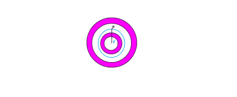

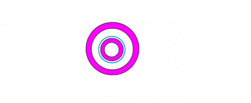

For example, say you want the field in the space between the two conducting shells. So draw a Gaussian sphere in that region. What is the charge contained within that Gaussian surface? Answer that and we can proceed.
The charge enclosed by one of the(inner) conductors.
Give me the charge in terms of q.
Shall I refer picture in op.
Yes, that's the problem we are discussing. The one you started the thread with.

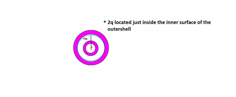

Zero.Because there is +2q and -2q.
No.
I suspect the diagram is throwing you off. For some reason, there is a blue circle drawn in the space between the two conducting shells (where p3 is). That circle is labeled as "+2q", implying that there is some charge just floating in space. I doubt that's what you meant. I think you meant to show that the inner surface of the outer shell has a charge of +2q.
Until this is straightened out there is little point in continuing.
But +2q is in between the two conductive shells.
Really? Why then doesn't the problem statement say that? If true, that changes everything! (But I doubt it's true.)
