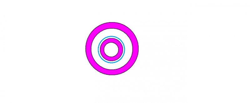

You have two concentric shells. The pink regions are conductors, the electric field in a conductor is zero.
The empty spaces are voids, there are electric fields inside them, except the central part enclosed by the small shell.
The geometry has spherical symmetry, so is the symmetry of the field.
The charge on the shells can move and redistributed, but no charge can leave any of the shells.
Consider a Gaussian sphere inside the innermost void. There are no charge enclosed, the field is zero.
Consider a concentric sphere inside the first pink region. The electric field must be zero, so that Gaussian sphere does not enclose any charge. There is no charge inside the conductor or on the inner surface of the shell.
Consider a sphere just outside the first shell. How much charge does it enclose? What is the electric field at radius r in the region between the shells?
Consider a sphere inside the outer pink region. It is conductor, the field is zero. How much is the enclosed charge then?
This sphere encloses the small shell and the inner surface of the big shell. How much is the charge that compensates the charge of the inner shell?
Where can this excess charge be distributed? It can not be inside the metal. It can not leave the shell. Where is it?
If there is some charge on the inner surface of the big shell, how much is on the outer surface?
like this?
Diagram of concentric circles on a white background: a large magenta ring, a smaller magenta ring, and a thin blue circle between them, all centred on the same point.
You have not shown any charges.

Yes, it is the original problem. The inner shell has total charge -2q and the outer shell has charge +4q.
gracy said:
-2q.
That's where I am stuck.
What does Gauss' Law say?
gracy said:
is my post #78 correct?
Yes, the enclosed charge is -2q.
you mean at p?
Diagram of concentric rings: two solid magenta annuli separated by white gaps, with a dashed blue circle between them. A radius line labelled r runs from the centre to a point labelled p on the outer edge of the blue circle.
Yes, at P or at any other point at the same distance from the centre.
I am not sure about charge enclosed by this gaussian surface.I know that there is -2q but is +2q also inside it?
That Gaussian surface encloses the small shell, and some from the void. There is -2q charge on the small shell, and no charge in the empty space. Why should be 2q also inside it??
it is still between the shells.
Cross-section diagram of two concentric thick magenta rings on white, with a thin blue circle between them and a radius line labelled r from the centre to the inner edge of the outer ring.
Yes. So what is the electric field? I would like to see the formula.
If i refer picture of post #87 it will include +2q charge also
NO. Why do you think so?
