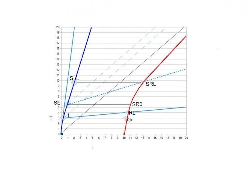

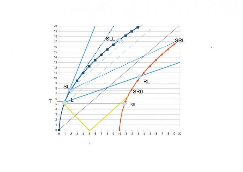

Thank you. I was confused because I had a wrong understanding of definitions. I've checked them again and it makes sense. Back to the original post, when I've started it, I thought time dilation occurs due to difference in gravitational field values not gravitational potential. In that case gravity wouldn't have been equivalent to acceleration. However, gravitational potential difference, alone, does not explain how time dilation occurs.
I've also found an explanation using space-time diagrams which didn't look very clear at first then I've plotted a graph of a constant acceleration and apparently, if you select any two points on x axis, you always get different velocities between them, which means you can apply simple Lorentz transformations. That is counterintuitive.
Then apply the equivalence principle.
That is actually wrong, meaning its not counterintuitive. We need acceleration curves separated by a distance on x-axis for two accelerating clocks.
Can you clarify what you are doing here? You might want to also become familiar with these two different families of worldlines in Minkowski spacetime: the worldlines of Rindler observers (observers at rest in Rindler coordinates), and the worldlines of "Bell observers" (the worldlines that occur in the Bell Spaceship Paradox):
