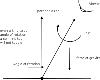

I have attached an image to further explain what my dilemma is

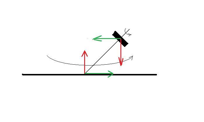

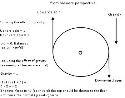

I'll try again with the attachments
broken into two due to size

Hi Romper take a look at the images, (shame they didnt show) you will see what I mean
your explanation works perfectly for a top with a vertical axis. its the off vertical that is of greatest concern

I have never seen math like this. Gravity does not attach itself to other forces. Gravity acts on the object as a whole.
