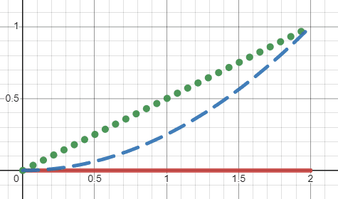

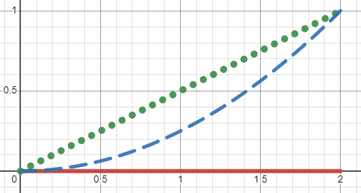

In addition to the earlier explanations, this might help:
On a position-vs-time graph,
the coordinate time is the "time" along the time-coordinate axis of the reference frame drawing the graph
whereas
the proper time [of an astronaut's worldline] is like the "arc-length of the curve of along the worldline"
(where "arc-length along the curve" on this diagram is measured by the astronaut's wristwatch).
In the position y-vs-time t graph below (t running to the right),
the coordinate-time of this graph is measured along the horizontal red line (y=0)
[which can somehow be "spread over space" to assign a coordinate-time to any point-event on the graph].
For these equal coordinate-time curve segments (from coordinate-time 0 to coordinate-time 2):
  • in Galilean physics (PHY 101), the three worldlines have equal elapsed proper-times.
  • in special relativity,
    the red worldline segment has the longest elapsed proper-time.
    The green worldline segment has a shorter elapsed proper-time.
    The blue worldline segment has the shortest elapsed proper-time among the three.
  • in Euclidean geometry, with the plot below interpreted as a y-vs-x graph (x running to the right),
    arc-lengths are measured by each path-surveyor's odometer.
    The red curve segment has the shortest arc-length.
    The green curve segment has a longer arc-length.
    The blue curve segment has the longest arc-length among the three.
