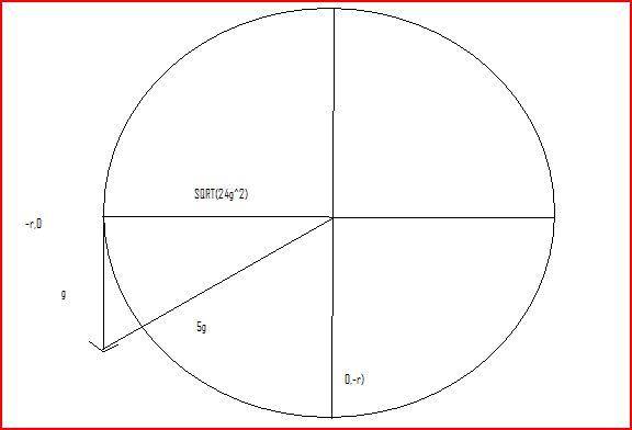

Without a detailed sequential diagram, it can be hard to conceive of a mental modelling. Why is it 4g down? Acceleration is always in the direction towards the center, isn't it? Let's just say that when the pilot is at the point (0,-r), he experiences a 4g acceleration towards the center. At the same time, there is a 1g acceleration in the direction towards the ground. But, why, as you'e put it, would the 4g acceleration be in the direction towards the ground? How did this 4g acceleration, initially towards the center changes vector suddenly. It doesn't make sense.
I've made a small picture for this.
cg=centrifugal g
gg=gravitational g
As a g force for a human only the downward g(from a human orientation reference) is significant as it is the one that increases or decreases the pressure in the head.
All I am saying is that you would have to have a varying radius in order to keep 5g's. Otherwise you would get more at the end of the turn.
cg=centrifugal g
gg=gravitational g

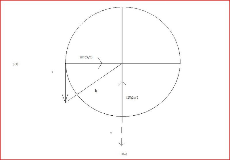

Post #26:
1.Without a detailed sequential diagram, it can be hard to conceive of a mental modelling.
2.Why is it 4g down?
3.Acceleration is always in the direction towards the center, isn't it?
4.Let's just say that when the pilot is at the point (0,-r), he experiences a 4g acceleration towards the center.
5.At the same time, there is a 1g acceleration in the direction towards the ground.
6.But, why, as you'e put it, would the 4g acceleration be in the direction towards the ground? How did this 4g acceleration, initially towards the center changes vector suddenly. It doesn't make sense.
1. I agree. Here's another picture, a continuation from the post#22 picture, with the origin shifted to where you have it too.
A. Coming down along a straight line with constant speed. 1mg downward force from the gravitational field of the Earth is counteracted by the pilot's restraining belts. The pilot experiences 1g downwards (for him: forward, towards the nose of the plane, towards the earth) but doesn't accelerate because the forces executed by the belts hold him at the speed of the plane. This is what we call the normal force in static cases: eg. pilot's weight on chair in office: force mg down, equal but opposite normal force up: zero sum, no motion. What you feel in such situation is called 1g. In the picture: 'felt' 1g down, 'felt' acceleration: red Arrow, size g, up. This is present constantly throughout the entire flight of the plane.
B. The moment he pulls the stick and the plane executes the command, he starts to describe a circle. The OP wording and our state of knowledge about kinematics kind of dictate that the plane's trajectory is a quarter part of a circle. Required centripetal force: 4 mg (value to be justified later) towards center, so at point B that is in positive x direction. Required acceleration: 4g in positive x direction. In addition to that, the 1g from before still applies.(What is an SHM model?). Acceleration 4g in positive x direction plus 1g in positive y direction add up to the purple vector sum. Dotted lines: this is how you add vectors, with a parallellogram. Magnitude of the actual acceleration: √17 g. The pilot experiences this √ 17 g in exactly the opposite direction: he was already leaning in his belts (1g), now he's also pushed into his chair (4g).
C. Centripetal force has turned a bit and aligns more with the normal force. Less strain in the belts, more push from the chair.
D. even less belts, more chair
E. Lowest point, just before pilot pushes back the stick to go to level flight. Acceleration to describe circle still 4g, straight up. Acceleration to counteract gravity and NOT fall towards the Earth any further 1g, straight up. Two independent effects, combined to add up to the pilot experiencing 5g pushing him down in his seat. Just what he can stand while remaining conscious. Hence the 4g at B.
Still E. Plane is now horizontal and pilot pushes back the stick to go to level flight. Plane obeys instantly. No more circle. Acceleration to counteract gravity and NOT fall towards the Earth 1g, straight up.
F. Level flight. Force to counteract gravity 1 mg, delivered by the seat. But the pilot feels 1g down.
2. It is not 4g down. I used
So initially he feels an acceleration of 1 g down, 4g to the right
Which was wrong and confusing. My apologies.(*) He feels 1 down, 4 to the left. He is accelerated by an acceleration 1g up (belts) plus 1 g down (gravity) and 4g to the right. That way the net force is towards the center of the circle .
This centripetal force rotates ##+\pi/2## until it is 4mg up. Gravity is still there and needs to be counteracted by another 1mg up. Pilot feels 5g pushing him down in his chair.
(*)I realize I repeated this error by copying to post #35 without checking. Sorry once more. Lot has predictive gifts!​
3. For uniform circular motion in the absence of other forces: yes. In this exercise, there is another (constant) force present: Earth gravity.
4. Yes.
5. There is a 1mg force down. But we were told the plane moves at 1200 km/h, a constant speed. Not unreasonable: the air resistance at such speeds is hefty. I would vote for counteracting this 1mg so the trajectory becomes a circle and we can apply our ^v2/r
6. See the apology under 2. I confused you and didn't realize I had done so. Then I made it worse by repeating.

And so much more clearer. I was rather confused at the outset with the whole "pilot feels 1g acceleration down ward but has a 1g acceleration upward"-rather contradictory initially- but it seems the arrow in the diagram indicates the corollary of what the pilot is subject to-that is, it indicates an opposing acceleration.
And so, the diagram now makes sense. It's so much easier to work with a real-time visual model in my head.
To end the problem, all I've to do is apply the g = v^2/r with g = SQRT(17g^2), yes?

A couple comments on your notations: "g = v^2/r" is more meaningful and better written as acentripetal = v2/r
(use the [Go Advanced] button and use the X2 and X2 tools. Use the [Preview Post] button you see if what you did looks like what you expected)
"g = SQRT(17g^2)" is based on what, again?
The point made clear in BvU's the last post was that at every point in the turning phase of the flight, there is a vector sum of the acceleration due to gravity, ag, and the acceleration due to the circular motion, acentripetal. The magnitude of this sum cannot exceed 5m/s2.
Can you tell, from inspection, which of the points in BvU's diagram (B, C, D, or E) represents the largest magnitude of the vector sum?
From that point, you get what you are looking for: the maximum acentriptetal.
From acentripetal = v2/r, the maximum acentripetal gives the smallest r, which is the height that you are looking for.
Edit: I meant "5g m/s2"

The point made clear in BvM's the last post was that at every point in the turning phase of the flight, there is a vector sum of the acceleration due to gravity, ag, and the acceleration due to the circular motion, acentripetal. The magnitude of this sum cannot exceed 5m/s2.
Can you tell, from inspection, which of the points in BvM's diagram (B, C, D, or E) represents the largest magnitude of the vector sum?
E is the greatest. It has an acceleration of magnitude 5g.

Oops. I still would use a 4 here instead of a 5. The difference is reserved to deal with the omnipresent small red arrow pointing straightupwards. In particular at point E in the last moment before letting go of the stick. To explain this, I took quite some time to compose #45. Might have made mistakes (again -- if so, please point them out), but it's better than post #25.
The 5 is applicable in Iewando's scenario number 3. But the Earth is damn nearby.

Regardless the 4g or 5g, how did you arrived at the 4g to the right? I would really appreciate the explanation:biggrin:
  • #52
To the right of what ? I thought we had at last had agreed upon a coordinate system. This by now is a long thread.
Let me make a wild but educated guess. (btw It's the guessing what the other guy means exactly, that makes this whole thing so time consuming, almost exasperating. For all parties involved.).
I thought we had at last agreed upon a coordinate system. I use it. I posted a bunch of pictures with letters and arrows. I refer to picture in post 44 and my educated guess is you are referring to point B, point (0,0). There is an eight line explanation with a cliffhanger: to be justified later. Under point E explanation the veil is lifted: the happy end is "hence the 4g at B".
So the way I think about this thing is:
1. Don't complicate it more than necessary: assume constant speed.
2. You suffer 1g behind your desktop. If you pass out at 5 g, you can stand 4g extra from acrobatics like looping and such -- in a worst case where Earth and acrobatics pull in the same direction.
3. If all you want is to get out of a nosedive, a quarter circle is what you need and have sufficient knowledge to do some calculations on. Iewando's complications are for SMH (what on Earth or in heaven is that?) or post-BS.
4. Combine 2 and 3: a quarter circle with at max 4g normal force in the vertical upward direction to deliver the centripetal force needed to describe a circular motion is what the exercise wants us to work on.
5. We know a constant acceleration is needed for circular motion. Acceleration is a vector. It points to the center of the circle. Acceleration from Earth gravity is also a vector. It points downward (or rather: towards the center of gravity of the Earth - don't ask). From a simple sketch it becomes clear that the worst case (i.e. Earth and acrobatics pulling in the same direction, so that the vector addition comes down to a simple magnitude addition is at point E, at the very end of the quarter circle.
6. Combine 1 and 5: 4g is available for the quarter circle.
So in response to your question (as I guess it was meant): 4g is the max available. It the trajectory is to be a quarter circle and the speed constant, the centripetal acceleration has to be constant in magnitude and has to point to the center of that circle. So initially, at point B, after a jerk on the stick, it has to point in the positive x-direction in the coordinate system we agreed upon. And its magnitude is 4g. Big red arrow.
Now, what makes this exercise so difficult for you: There is a difference between what the pilot feels and the net acceleration. Behind a desktop (on earth, please), you feel 1g. But you don't fall because the chair holds you in place by exercising exactly 1g upwards. The normal force in school books. In this exercise the pilot feels an acceleration that is equal to the opposite of the purple arrows (purple is unique so far, so I don't specify that it's in the picture of post #45). The net acceleration is ZERO until point B (hence a straight line, constant speed. Newton!), then from B to E the net acceleration is a vector, magnitude 4g and pointing to (r,0), the centre of the circle (hence the circle, and hence a radius v2/4g), and after point E the net acceleration is ZERO again, hence a straight line, grazing the surface of the Earth at constant speed.
Unhealthy, but we were asked to calculate the minimum height, regardless of tree heights ;-)
