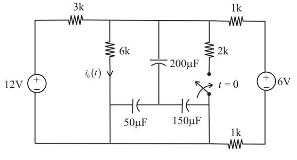

Hi All.
Can someone give me some tips/tricks for reducing these capacitors?
I understand that, when reduced, the value is 100uF but I don't get it...
Thanks for your help.
Where I got the 100uF...
My source states that 50 || 150 and in series with the 200...
How is that? I just don't see it.

What do you mean by "reducing" those 3 capacitors? Are you thinking there is some parallel/series combination, or a Y-Delta transformation? I'm not seeing those, but I could be wrong. I would just attach a ground symbol to the bottom of the left voltage source and write the KCL equations for before and after the switch is closed and solve for the voltages and currents.

So, have you tried the KCL approach? Or has the instructor said that there are simplifications in this circuit that make the problem easier?
Focussing on the 50uF and 150uF caps we see each has one plate connected to the other (and this junction connected to the 200uF), and the remaining plate of each is likewise connected to the other's (they are sharing a common node). So the 50uF and 150uF are parallelled.

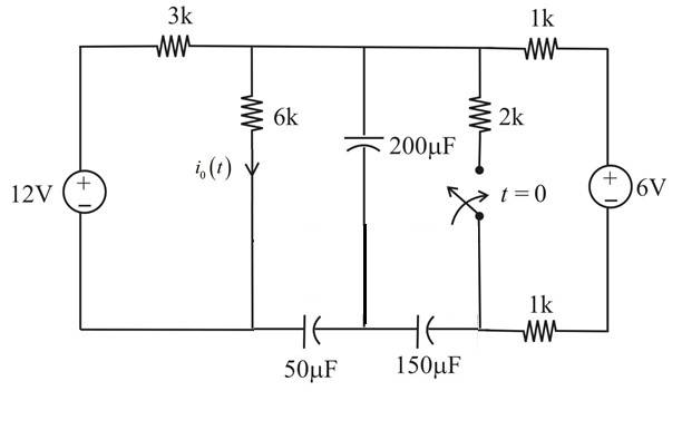

ohh.. In my mind I was going through the resistors to try to see the parallel. I was looking at the circuit like this...
I see it now... Thanks a bunch!
From your first diagram, the series connection of the 50 and 150 uF capacitors are in parallel with a short circuit.
You might want to check out the wye to delta conversion. The initial configuration of the 3 capacitors is a wye connection.
Be careful not to disinform the OP. In the first diagram the 50μF and the 150μF are not in series.
