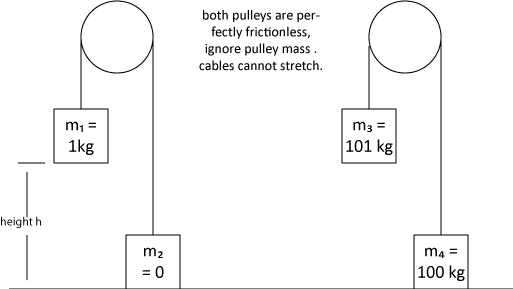

I got into a disagreement with a fellow student today. He insisted that it's possible to simplify the system on the right as the system on the left. I agree with him that the difference in potential energy (and, therefore, the kinetic energy) is the same but I insist that the final velocities of the two systems will differ. We ended up surveying 6 different physics / engineering students and all agreed with him at a glance. One did text me tonight that he's on my side after having done the problem on paper.
All of the engineering and physics profs were at lunch and couldn't be reached. I intend to ask at least one of them in Physics 2 in the morning.
Given:
Release both systems from rest (initial velocity = 0). Assume no moment of inertia for pulleys, massless, non-stretchy cable. You can simplify the box with mass=0 as an empty rope end if you wish.

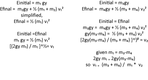

I am basing my predicted results on energy theory, since there are no outside forces acting on the system, Ei = Ef.
I worked this out on paper and believe it confirms my intuition that you cannot equate the two systems to simplify a problem.

Your analysis is correct except that your final equation relating ##v_1## and ##v_2## is missing a square root in part of the equation.
Definitely, ##m_1## will acquire more speed as it falls. It is essentially in free fall with acceleration ##g##. Masses ##m_3## and ##m_4## will have much less acceleration (about .005##g##). The net force accelerating the two systems is the same, but the system on the right has much more inertia.
You are right, the problem can not be "simplified". Both the acceleration and the speed of the blocks depend both on the sum and the difference of the masses.

...you cannot equate the two systems to simplify a problem.
Depends on the problem - depends what you mean by equate".
By context - the problem is to find the speed of the left-hand mass after falling, from rest, through a height h.
You can see that the second case is cannot be equivalent because, if m4 were removed, then the final speed of m3 would be the same as the final speed of m1 (acceleration of gravity does not depend on mass remember?) Adding any mass to the right hand side can only reduce the final speed.
No need for calculations - nothing but physics :approve:
You nay be able to convince the other, without appeal to authority, by starting out with the first case ... they should agree.
Staying with the first case - ask what will happen if any mass is added to the RHS.
Then go to a bigger mass on the left and zero on the right ... ask what the final speed will be compared with the first case... (correct if needed) ... then ask what would happen if any mass is added to the RHS.
Thank you! That's what I kept saying! Yes that's a typo on the bottom, I was considering substituting one expression into the other so was changing around the square roots and stopped halfway.

The original problem is to find the velocity right before impact. Originally there was a moment of inertia for the pulley, on which the rope could not slip, so angular velocity had to be considered.
The student wanted to simplify by subtracting the two masses, (he came up with the 0, 1, 100, 101 in the diagram) and I said he couldn't because the total mass affects the system's inertia and therefore affects the final velocity.
Everyone else agreed with him. Their rationale was that it was gravity doing the acceleration, and gravity is a fixed acceleration (not dependent on mass), which is true enough on Earth's surface. But in this problem Tension is involved.
We discussed it to death and nobody would agree with me. The root of the problem was that the acceleration was gravity and everyone seemed to think that gravity didn't care how much total mass there was given the same Δm.
