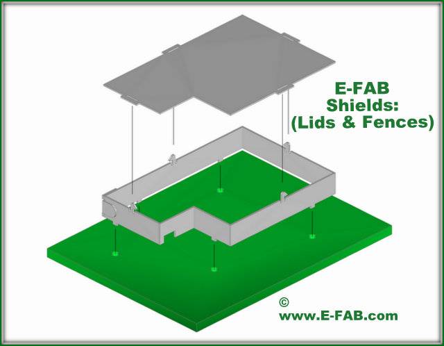

Yeah, and consider a covered shield fence around each of the stages -- I've had real problems getting ganged amps at the same frequency to not oscillate...
https://e-fab.com/news/wp-content/uploads/2014/04/Shield_3D_1.jpg

What is this, picture?

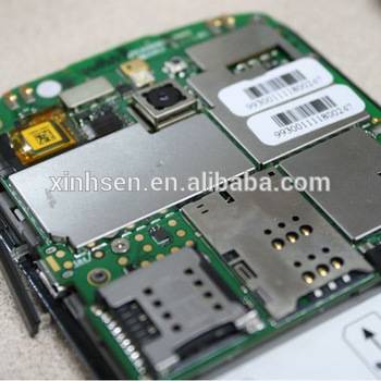

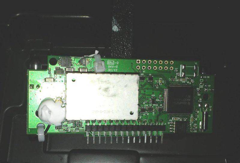

It is a drawing of an RF shield fence and top. They are commonly used on RF circuit boards to shield the components underneath from RF interference from other sources, and to contain RF energy being generated by the circuitry under the shield. I've used them in 2.4GHz Zigbee radio designs, for example. Here is a picture of a typical circuit board with several sections of RF circuitry that are using shields to lower cross-talk between them, and to protect against outside interference:
https://sc02.alicdn.com/kf/HTB1jeUO...tal-etching-EMI-RFI-shielding.jpg_350x350.jpg
And a picture of my PCBA with the radio section under the metal shield can:
