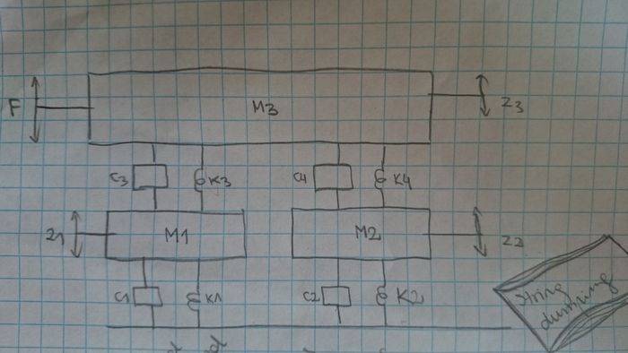

Hi!
I have this project on my CAE classes in which I have to design a system like this,
Hand-drawn schematic of a mechanical system on graph paper: mass M3 at top with force F and displacement z3, masses M1 and M2 below with displacements z1 and z2, each connected by springs c1 to c4 and dampers k1 to k4.
which would be in equilibrium, so i guess that the masses should move with the constant amplitude. I have no idea how to calculate the k parameter, I tried to do this analogically to mass-spring damper system, but nothing good came out of it. Can anyone help? Would really aprreciate :)
http://people.clarkson.edu/~estradjm/FinalProjectDNS.pdf should help you. Look for "half car model" or "quarter car model" for more examples.
