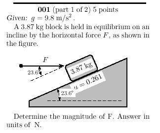

Q1. A 3.87 kg block is held in equilibrium on an incline by the horizontal force F. The incline makes a 23.6 degree angle with the horizontal. Determine the magnitude of F. Answer in units of N.

Oops...I forgot to mention that the coefficient is 0.261
Ah...I'll just attach the question lol...The figures will help, am sure.
I was thinking that maybe I could use Fx = macosA but then I don't know the acceleration...or maybe mg? Gravity being 9.8 m/s^2
I am not sure if it attached the file earlier...hmmmm

Resolve parallel to the inclined surface.
FCosA = mgSinA + umgCosA
where u = coefficient of friction, m = mass, g = gravity, A = slope angle.

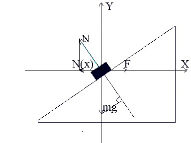

Condition of equilibrium:
Nsin([alpha])=F,
N=mgcos([alpha])+Fsin([alpha]),
mg=Ncos([alpha])
