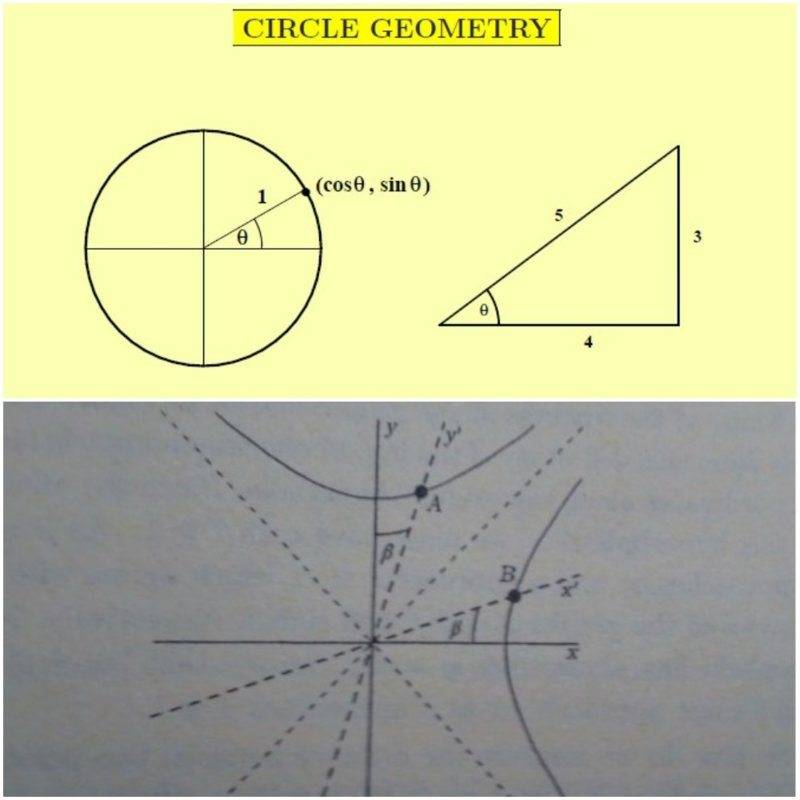

Gaussian97 , In the case of circle geometry, we see distance r. Where is the distance ρ in hyperbola picture? Is it from the origin point to point B ? Now I hope you understand my question.

@Adwit What do you mean that we "see" distance ##r##? Distance is not a thing you can see, what you see are two points (usually connected by a line) and you can write an ##r## to express that they are at a distance ##r##.
Then, following the same reasoning, you can join the two points (the origin and the point B) by a line and write a ##\rho## next to it to tell that these two points are at a distance ##\rho## from each other. But in the same way, you can draw a line to the point A and write ##\rho'## next to it. In general, you can draw a line to any point with cartesian coordinates ##(x,y)##, and write a ##\rho## next to it to express that this point is at a distance ##\rho## from the origin, and then, you can compute the numerical value of ##\rho## using
$$\rho = \sqrt{x^2-y^2}$$

Of course, distance is a thing you can see. When I draw a line which connects two points, that line is the distance either it is in hyperbola or circle. That is what I mean by saying " we see distance". Understand?
That pictured line is the distance. Everybody in the world thinks that the connector line is distance. Why don't you think that way? You can see distance. Distance is not only something to measure, but also something to see, something to feel.
Adwit said:
Can you show me where is this distance in the hyperbola picture?
It's the distance along the ##x## axis from the origin to the hyperbola--in other words, the distance of "closest approach" of the hyperbola to the origin.
Then I don't understand your question, if ##\rho## is the distance to point B, obviously you see it in your picture as the line connecting the origin with point B. But if ##\rho## is the distance to point A, obviously you see it in your picture as the line connecting the origin with point A.
Maybe you are asking at which point in the parabola does the "hyperbolic distance" equal the "Euclidean distance" then, of course, it's in the only point in your parabola for which ##y=0##.
In the picture, ρ is not written. I didn't know either ρ is the connector line from the origin to point B or A or it is any other line ? I didn't know which line is ρ . I wanted to know which line indicates ρ .
In your original post, the image says:
Measure the "squared distance" of the point B with coordinates ##(x,y)## from the origin by using the definition ##\rho^2 = x^2 - y^2##
So, in this case, ##\rho## refers to point B and therefore you should draw it as the line connecting the origin with point B.

The definition of "distance" for hyperbolic geometry, as the image you posted said, is not Euclidean distance. In terms of hyperbolic "distance", every point on the hyperbola is the same "distance" ##\rho## from the origin. But this notion of "distance" is not Euclidean distance. In terms of Euclidean distance, as I said in post #19, ##\rho## is the "distance of closest approach" of the hyperbola to the origin. As the hyperbola is drawn in the diagram, that means the distance along the ##x## or ##y## axis from the origin to the hyperbola.
That's my point! You have to forget about the Euclidean idea of distances as soon as you draw a minkowski diagram. The hyperbolae drawn in #1 are the locations of points of "constant distance" in the sense of the Minkowski pseudo metric.
