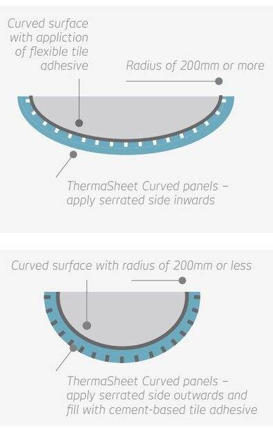

In bathroom remodelling, curved surfaces are made by serrating polystyrene (XPS) board and bending it. But there are no instructions on how to make the cuts to get the board to curve spherically. Is it possible somehow?
Example of normal application:
What i'd like to achieve:
More information:
Wedi board serration either straight or angled depending on radii wanted.
It's also possible to serrate outwards to achieve radii less than 200mm (example from ThermaSheet)
Any ideas on how to do this?

It will not be possible on only one side of the sheet, without cutting wedges from the sheet and then stitching them together, like a soccer ball made from pentagons and hexagons.
If you can cut V'ee slots, close together on both sides of the sheet, then you can shrink the peripheral area to approximate a spherical surface.
If you cannot bend a sheet of paper to the surface you want, then it cannot be solved with V.ee slots on one side only, so you will need to compress surface area with slots on both sides, a bit like a concertina.
