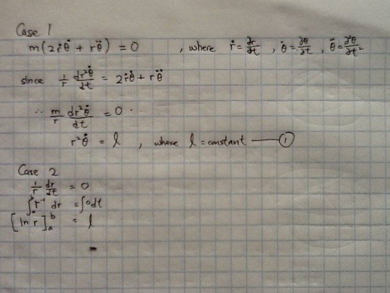

How to integral ? How can they ignore that variable?
  • Thread starter Thread starter Outrageous
    Integral Variable
9 replies · 2K views
Outrageous
373
I don't understand case 1. In case 2 that is normal integration , isn't?
Then why case 1 can simply ignore the r ? I don't think r is constant.
Please guide. Thanks
This way? No sure is that correct .

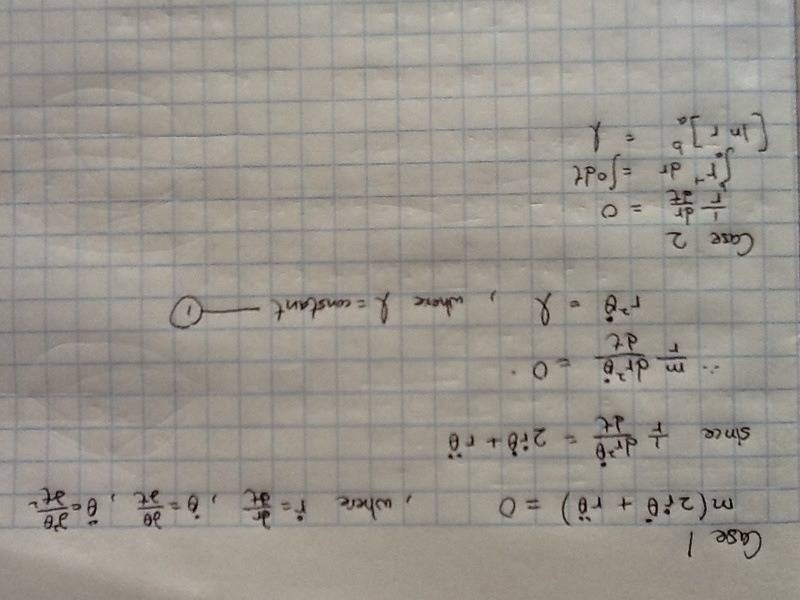

Sorry, I don't really know how to use it.
Are you talking about the equation$$
\frac m r \frac{d(r^2\dot \theta)}{dt}=0$$giving ##r^2\dot \theta=l##? If so, they didn't ignore the ##\frac m r##. They multiplied both sides by its reciprocal before integrating.
I'm not quite sure what you mean. Nobody said r was constant. But the fact that [itex]\frac{d}{dt}(r^2\theta') = 0[/itex] does imply that [itex]r^2\theta' = C[/itex] is constant (why?).
(1/r)(dr/dt)= 0 , (dr/dt)= 0
∫ dr = ∫ 0 dt
The answer should be r = constant.
Isn't ?
Can the answer be ∫(1/r)dr= ∫dt .
Then ln(r/ro)= t. Integral from ro to r , and integral from 0 to t. ro is original value r.
I thought you said you were puzzled about 1, not 2.
∫ dr = ∫ 0 dt
Isn't ?
Yes, that's right.
##\int \frac 1 r\, dr = \int 0\, dt##, not ##\int 1\, dt##.
I got it. Thanks much
