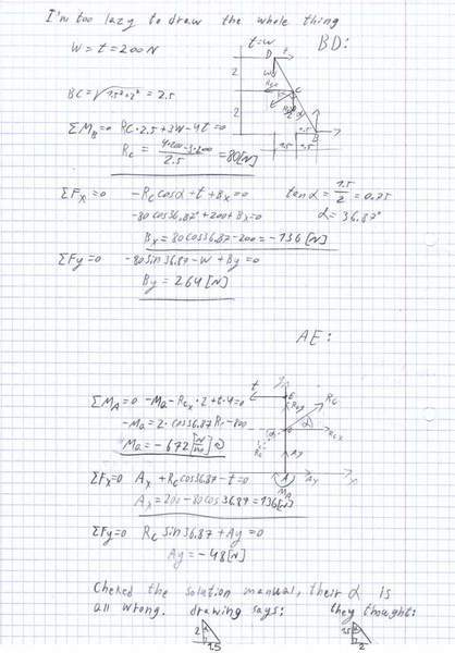

Long story short: A is fixed to the ground. Point C is a pin joint. W = 200 [N]
The rest is what you see is what you get.
I get too many unknowns no matter what I do.
If I look at only external forces (Which is what we were told to do with every "frame" problem such as this, this is what happens:
Sigma Ma = 1.5W - 1.5By +Ma = 0
(2 unknowns!)
If I do sigma Mb, I get 3 unknowns!
I can't build enough equations with similar unknowns to solve systems of equations.
Even when I look at each member individually I don't have enough to solve for anything.

C doesn't look like a regular joint.
It looks like it can slide freely along its length.
Edit: With C as a regular joint you cannot solve the system.

Writing your moment equation about point A is an unexpected choice. However, writing a moment equation about point B would, perhaps, allow you to solve for the reaction at point C.
To amplify my previous suggestions, instead of looking at the entire mechanism, draw a Free body diagram for the arm BD. By putting BD in equilibrium, it would then be possible to draw a Free body diagram for the arm AE and write its equations of equilibrium.

Assuming the pulley is frictionless and that the pin at C slides without friction in the slot, you should be able to find the force that the pin at C exerts on member BD. In doing this, I would suggest that you find the moment, MB, about point B (torque about point B).
Thanks, I solved it :smile:
All the frames exercises I solved so far had a regular good ol' joint that wasn't allowed sliding. Now we have a joint that's allowed sliding, so it became confusing because I was taken aback.
Also, we were told always to start by external forces, but here we start with internal forces, which confused me even more! But anyway, thanks to these replies and my classmate I finally was able to pin that problem down. :approve: Excuse the pun :wink:
Thanks a bunch! :smile:
For reference I'm attaching my friend's solution since I'm at work and have no scanner, but we got the same results
