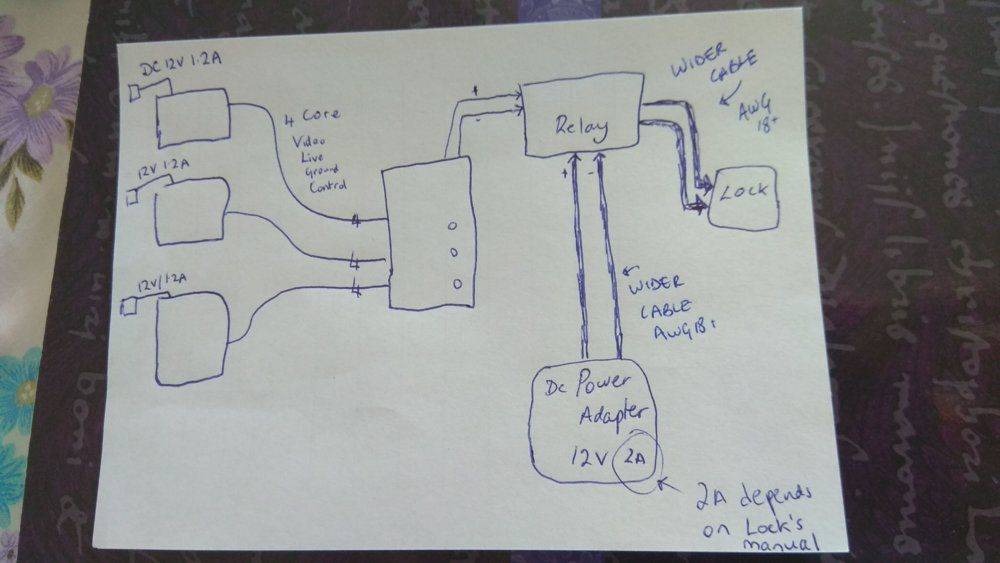

I have an intercom circuit with a pre-purchased lock. The intercom is rated at 1.2Amps while the lock needs 2Amps. How can I make them compatible?
Hi,
I have purchased an electric lock some months ago. Now I purchased an intercom system which is rated at 1.2Amps. The cabling is rated at 1Amp. The lock is working sporadically. I guess it is because of the current.
Is it possible that I boost the current received? Maybe through a relay? So basically power the lock with a 12V 2Amps DC transformer and use a 2Amp+ (AWG 18) cable while I send the power signal from the intercom to a relay switch?
Or it would be best to use a diode of sorts to increase the current?
As you might realize, I am quite a newbie in electronics, so please do spell out things for me, even at the risk of belittling me :)
Thanks beforehand

You need a relay fed by a separate power supply. A relay is a good idea even if the lock had the same rated current as the intercom. Just make sure that the power to the lock is correct for the lock. If the lock needs 12 volts, it gets 12 volts. If the lock needs AC (or DC), it needs AC (or DC). There is a huge difference between AC and DC when powering relay coils and locks.
No belittling implied. You recognized the problem and solution, and just needed some reassurance from somebody with more experience.
A diode will not increase the current.
Thanks for your reply and reassurance!
This is how I intend to wire everything.
The DC adapter for the relay and lock is actually a 30A adapter with 10A buffer over the 80% capacity so it can spare the extra 2A.
Much appreciated
If I were to buy this: https://www.ebay.co.uk/itm/DC-2V-24V-40A-5-Pin-Automotive-Changeover-Socket-Relay-Car-Bike-Van-Boat-Switch/312519193276?hash=item48c39872bc:m:mmwH6k_qlYR8mYUjPLmtwRg
how would I need to wire it because there are 6 cables in my diagram and all relays are 5. That means that the -ve from the power adapter goes straight to the lock right?

Right!

Thanks Tom.
But this is a brand new lock so one would hope there is no wear and tear already ;)
When I tried it with a 30A power adapter, it opened without any issue so it really seems to be an issue with current. Hence why the relay should fix the issue.
Thanks both for your help!
