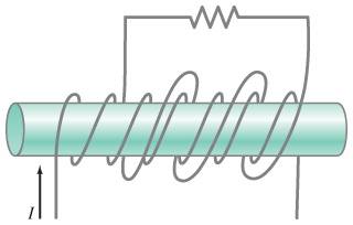

A coil with 170 turns, a radius of 5.0 cm, and a resistance of 12 ohms surrounds a solenoid with 230 turns/cm and a radius of 4.7 cm; see the figure. The current in the solenoid changes at a constant rate from 0 to 1.8 A in 0.11 s.
Calculate the magnitude and direction of the induced current in the 170-turn coil.

I tried to take equation 1 and compute the emf for a single loop, then I multiplied that times 170. I then divided that by 12 to get the current. However, MP says it's wrong. My result was 0.053 A using n = 23,000 turns/m, A = pi * 0.05^2, and dI/dt = 1.8/0.11.

I got the same number for the current as you. What direction did you give for the current in 12 Ω resistor? Maybe that's what you got wrong.

The B field is confined to the solenoid. Instead of the area of the loop, you should use the area of the solenoid.
jchoca said:
My result was 0.053 A using ... A = pi * 0.05^2 ...
This is not the correct radius for calculating the area of the solenoid.

Oops, I missed that even though I looked to make sure that the correct solenoid radius was used. :headbang:
