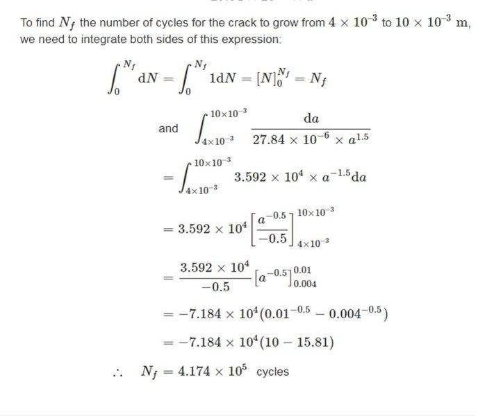

1. The problem statement, all given data
I've been working through one of the lessons for my HNC and I'm totally stuck on how they got from 27.84x10^-6 to 3.593x10^4. I can follow it all fine including the integration after that section it's just the inbetween that I can't seem to get my head around! Any help would be greatly appreciated!
They may have used the ##1/x## button on a calculator!
Likes berkeman and PCal
Yesss! Thank you!
