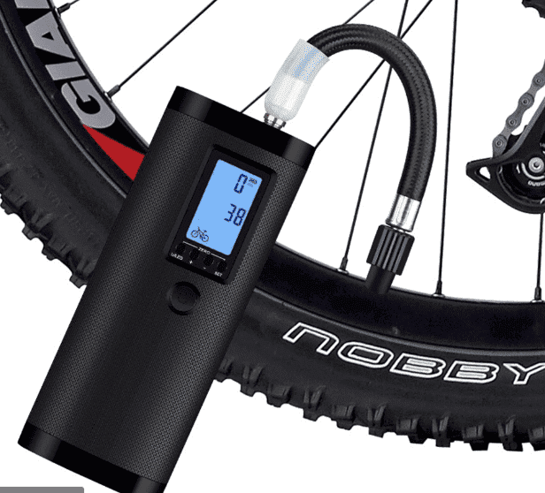

I think it would be much easier to pump water out at constant pressure, than to pump air in and maintain pressure as the tank empties.
But, you could use a portable air compressor provided that it could be set to a low enough pressure. 1 psi should be plenty. But since the commercial ones are meant for tire inflation, it is possible that they can not be set as low as 1 psi.
Black handheld electric tyre inflator with a blue LCD display showing a reading of 38 and a bicycle icon, connected by a braided hose to a valve chuck, held against a mountain bike wheel with a Nobby Nic tyre.
