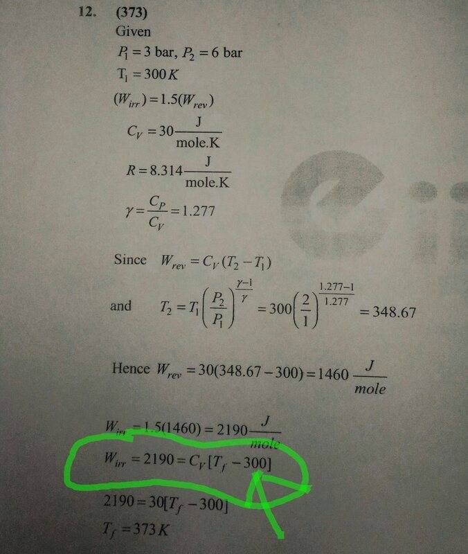

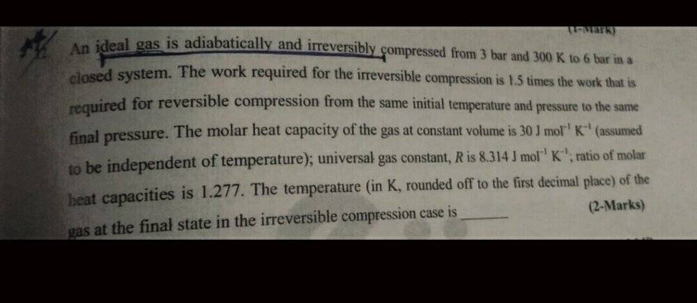

I have one problem statement here
And here is the solution provided of it
Why while equating the irreversible work we are using formulae Cv(Tf-Ti) , which is derived for a reversible process? Is it because the question says work(irreversible)=1.5Work(reversible) or its because we have ideal gas in working ?
Rahulx084 said:
Thank you so much sir . Things are much clearer to me now .
For an ideal gas, because internal energy is a material property that is function of temperature only, the change in internal energy, regardless of process path is $$\Delta U=nC_v\Delta T$$. So $$nC_v\Delta T=W_{irrev}$$ for the irreversible path. Notice that I used ##\Delta## to represent the change between the initial and final states.
Ohh yes , my bad sorry. Thank again sir . If I will face any problems further in this course , I will add it in this thread . :)
