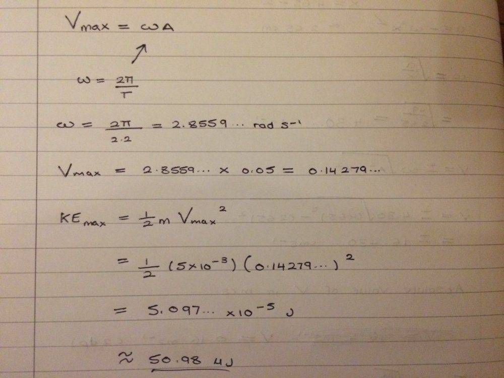

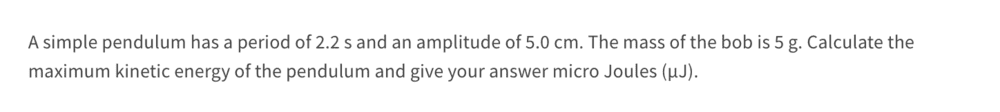

Calculate the maximum kinetic energy of the pendulum
angular speed = 2 pi/T
KE = 1/2mv^2
So I have been given a question here which asks me to work out the maximum kinetic energy of the pendulum
It has given info such as time period and amplitude, which I had then made use of these formulas
Does a kinetic energy of approx 50.98 micro joules seem right here?
Any help would be great! Thanks a lot
I think it's okay (I didn't pay very much attention to the numbers). But if you were my student, I would highly recommend you to put always the units so, when computing ##v_{max}##, put
$$v_{max}=2.9 \text{ s}^{-1}\cdot 0.05 \text{m} = 0.14 \text{ms}^{-1}$$ and so on.
Bolter said:
Homework Statement:: Calculate the maximum kinetic energy of the pendulum
Relevant Equations:: angular speed = 2 pi/T
KE = 1/2mv^2
Looks about right.
You could calculate the answer using maximum potential energy to check it yourself.
How is "amplitude" in centimeters defined? Is it the change in elevation, or is it an arc-length? Does the answer (max KE) depend on the gravity field (are we on the Earth or the moon)? I'm trying to figure out if we need those defined, or if period (which gives L/g) is sufficient to answer.
You should not quote more significant figures than in your least precise input, so make it 51.
