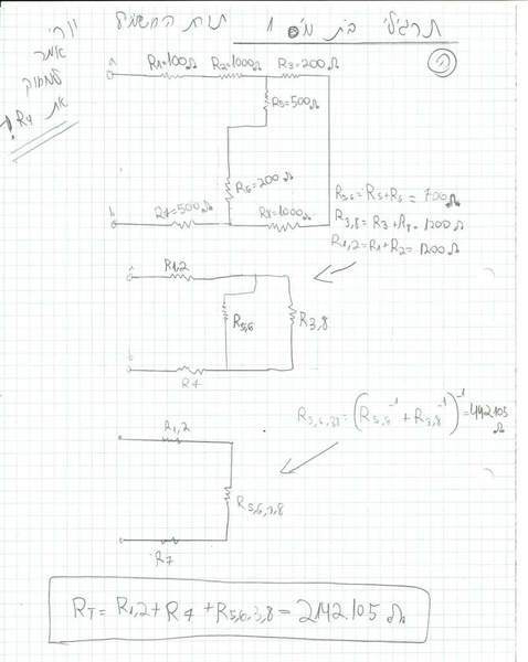

I just need to find the Req of the circuit. Everything is attached. Ignore the fact there's no R4.
Is it correct?

Your symbolic calculations are correct, yes. You have, however, added 100 Ohm too much in R1,2.
Ah, thank you for catching my thoughtless error :) unless anyone makes another reply I'm going to assume other than that it's all correct
