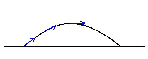

My professor did this question in class and I am a little confused. I wrote it down in my notes but I kind of don't understand it.
The question is: Find theta 1/4 of the way through the flight of a projectile in time
He does not give us numbers. Everything has to be solved algebraically.
My question is the angle at 1/4 of the flight the same as the angle of the projectile when it is fired?
And also is the slope of the tangent line at any point on the projectile the same as the slope at that point on the projectile?
Yes, the direction of the projectile at any point in time defines the slope (tangent) of the curve at that point.
Edit: didn't pay attention to your first question. No to that one. The direction of the projectile is changing at each instant.

See the picture: It is the track of a projectile. Is the angle of the tangent of the trajectory is the same everywhere? It would be a straight line then!
Yes, the angle of slope of the tangent line is the same as the angle of slope of the velocity vector of the projectile. The velocity is tangent to the track of motion..
You need the angle the velocity vector encloses with the horizontal direction. How do the horizontal and vertical components of velocity change with time?

The slope at time t/4 gives you the direction of the velocity vector at that point. The angle of that slope is calculated as you show : tan theta = Vy/Vx. So you need to find Vy and Vx at that point in time. But that depends on the initial velocity of the projectile at the time it was fired, both it's magnitude and direction, so I assume that was given also as say V_initial at firing angle alpha? Note the firing angle and the angle you are trying to calculate are not the same, so call the firing angle alpha , not theta.

Assume that the initial velocity is of magnitude Vo and it makes the angle α with the horizontal.
You know that the motion of the projectile can be treated as a horizontal and a vertical motion. The horizontal one with constant velocity and the vertical one with constant acceleration. What are the horizontal (x) and vertical (y) components of the initial velocity?
How long is the projectile in air ? Denote it by T.
How do the components of the velocity depend on time?
You are right about the tangent of angle theta. If you have the equations for vx and vy, you can write up the equation for tanθ in terms of time, and substitute what you got for t=T/4.

So since tan=vy/vx
Vx is vcos
Vy is vsin-g(tf/4)

You need to distinguish between the angle of the trajectory at launch and the angle at t/4.

Ok, that makes sense. If the initial vertical velocity is viy then at time t later the vertical velocity will be viy-gt. So if we let T be the total time to land then at 1/4 of the time the vertical velocity, vy(T/4) will be viy-gT/4.
You wrote " Vy is vsin-g(tf/4)". That only makes sense if "vsin" represents the initial vertical velocity, viy. But in that case the implied angle in the "sin" must be the launch angle, not the angle at 1/4 of the trajectory time.
So please take much greater care to write complete equations and use different symbols for different variables: discriminate horizontal from vertical, and initial from final from points in between.

That's the velocity-time equation for one-dimensional motion. Now that you're looking at two-dimensional motion he's using that formula for each component of the motion.
In particular, for the vertical components of the velocity. He's combining what you learned about one-dimensional motion with what you learned about vectors.

Because in the horizontal direction acceleration is zero, so can be omitted.
jeff12 said:
If that is the case than why is Vx=Vcos, not like how Vy is found.
##v_x=v_{ox}+a_xt=v_o \cos \theta+a_xt=v_o \cos \theta##,
because ##a_x=0##.
##v_y=v_{oy}+a_yt=v_o \sin \theta+a_yt=v_o \sin \theta-gt##,
because ##a_y=-g##.

To clarify, theta in the above equations is the launch angle. Perhaps we should name this ##\theta_0##.
You're correct. The equations should be
##v_x=v_{ox}+a_xt=v_o \cos \theta_o+a_xt=v_o \cos \theta_o##,
because ##a_x=0##.
##v_y=v_{oy}+a_yt=v_o \sin \theta_o+a_yt=v_o \sin \theta_o-gt##,
because ##a_y=-g##.

Please, please do as I asked and take care to use different symbols for different variables. The equation as written above is obviously wrong. There are two different angles here, the launch angle and the angle at some later time. Likewise, you should use v0 (or somesuch) for the initial velocity and reserve the unqualified v for the velocity at an arbitrary time t.
Failure to make these distinctions is a major cause of confusion for students, and I strongly suspect is part of your difficulty with this question.
