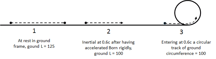

Here is one last follow up about the train. Say the train of 100 proper length starts at rest on a circular track of 100 circumference in the inertial ground frame. The front and rear of the train are touching, but not attached to each other. Is it possible to Born rigidly accelerate the train within the circular track? I think that it should be. The train can use the same acceleration program that it used on the straight section of track because proper acceleration is an invariant. So the train should accelerate Born rigidly (retain its 100 length) while length contracting in the ground frame (even though none of the parts of the train share a simultaneity surface because the train is traveling in a circle). In this case the train would not occupy the entire circular track because it would length contract to less than 100 length in the ground frame.

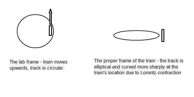

  • #46
PeterDonis said:
if the proper length of the train is to remain the same during acceleration in a circle, the radius and circumference of the track as seen in the ground frame, and therefore the curvature as seen in the ground frame, must change.
In the inertial frame:
radius : const
arc length : decreases
angle : decreases
curvature : const
In the co-rotating frame:
radius : const
arc length : const
angle : decreases
curvature : decreases

I have agreed with DrGreg that the curvature of the train decreases as measured by observers on the train. Here is a visual.
Say there are two parallel tracks very close to each other, each with a straight section leading into a circular section with ground circumference 100. A train of proper length 125 is on one of the straight tracks, and a train of proper length 100 is on the parallel straight track. Observers on the train paint meter marks along the trains, and verify that they line up between trains and that one has length 125 and the other 100.
Next, the 100 train moves into the circular section of its track and stops. It has the same length as the circle's circumference, so it occupies the entire track according to both its observers and ground observers.
Next, the 100 train accelerates as described before, using the same thrust programs that it would to accelerate Born rigidly if it were on a straight track to reach 0.6c, then remains at that speed. It contracts to 80 in the ground frame, but maintains its 100 length as measured by its own observers.
Finally, the 125 train accelerates Born rigidly on the straight section of its track to 0.6c. It length contracts to 100 in the ground frame but retains its 125 length as measured by its observers. It enters the circular section of its track. It has 100 ground length in a 100 ground circumference track, so it occupies the entire track in the ground frame; its front and rear ends touch.
The trains continue to move around the circular sections of the tracks. Here is how they look in the ground frame (I have separated the two for clarity; imagine that they are parallel and right next to each other):
The two trains are at rest with respect to each other. Observers on each train observe that neither has deformed; their meter marks still align; the one train still has proper length 100, and the other proper length 125. The 125 train is curved into a circle, with its front and rear touching, so observers on both trains agree that the circumference around which they are traveling has length 125. The ground circumference (100) is contracted compared to the trains' measured circumference (125) by gamma (1.25).
Finally, observers on the 100 train note that the curvature of the train is lower than it was at rest in the circular section of track. It started out curved with length 100 in a circle of circumference 100. Now it has length 100 traveling around a circle of circumference 125. In fact, if the 100 train accelerated to very nearly the speed of light, the length of the circumference that it would measure itself traveling on would increase to an arbitrarily large number, so observers on the train would measure their train to be nearly a straight line.
DrGreg said:
I think the rotating observer and the inertial observer disagree on what the curvature of the same circular track is . . .
Exactly. This is the basis of Ehrenfest's Paradox. The length of the circumference is shorter as measured by ground observers (100) than it is as measured by train observers (125).

I will restate. Start with a train of proper length 100 at rest in a circular track of ground circumference 100 in an inertial ground frame. The train occupies the entire circumference of the track. The front and rear of the train are touching but are not connected. Here the track is a solid line and the train a dashed line, with the front and rear marked by solid circles.
Next, the train accelerates to 0.6c going around the track using the same acceleration pattern that it would use to accelerate Born rigidly if it were on a straight line of track (that is, greater proper acceleration at the rear, and lesser proper acceleration at the front). The train contracts in the ground frame to length 80 in the same way that it would if it were accelerating Born rigidly on a straight line of track (from the rear forward, because the rear has a greater speed in the ground frame sooner than the front). Now the train simply goes around and around the track at 0.6c. It looks like this in the ground frame:
If an observer at the rear of the train radar measures the train's length (say the inner side of the train is mirrored, so the radar signal skims along the train from rear to front, where it reflects and returns skimming along the train to the rear), the radar length remains 100. So the radar measured own length of the train is 100, whereas the ground length of the train is length contracted by gamma = 1.25 to be only 80.
Do you agree?

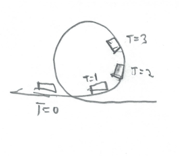

  • #54
Thanks all. Let's call what we just discussed the first problem
pervect said:
The second problem is what happens when the train leaves the straight track and enters the circular track. I'm not sure the motion for the second case has been discussed in great detail . . .
So let's see whether we can agree on what happens in the second problem, when the train leaves the straight track. The scenario, using numbers that keep the circular track circumference consistent, is as follows.
Start with a very thin train of proper length 125 at rest on a straight track in an inertial ground frame (step 1 below). Next, the train accelerates Born rigidly on the straight track to 0.6c -- its ground length contracts to 100 (step 2 below). Next, a shunt directs it into the circular section of track (step 3 below).
Finally, the entire train is in the circular section of track and stays there, traveling around and around. The train has ground length 100, and it is on a circular track of ground circumference 100, so the train occupies the entire track. The train's front and rear are touching.
The two questions are:
(a) does the train's length deform in the process of entering the circular section of the track?
(b) is the train's radar measured proper length while it is in the track still 125? Assume again that the inner side of the train is mirrored, so an observer at the rear can send a radar signal toward the front; the signal skims around the surface of the train to the front, where it reflects and then skims back around to the rear.
The question is a bit ambiguous, but I believe that both the proper length of the train and the length of train in the lab frame remain constant as I answered the last go-around. From context, since you ask about the proper length of the train, I assume that when you say "length" you actually mean "length as measured in the lab frame". You have to specify the frame in which you measure non-proper length in order to be non-ambiguous, because the non-proper concept of length is frame dependent.
Yes.
Additionally, as we also mentioned last time, in the lab frame the clocks synchronized in the train frame are not synchronized in the lab frame, and the offset in the lab frame is the same before, during, and after the train goes around the loop.

DrGreg said:
I think the rotating observer and the inertial observer disagree on what the curvature of the same circular track is: they . . . disagree on its circumference
Circular motion is like the barn and pole for ground observers -- they observe the moving train to be length contracted, so the train of proper length 125 fits entirely in a circular track of ground length 100. But for an observer on the train, it is the opposite of the barn and pole. The train observers do not observe the ground length 100 circular track to be contracted -- instead, they observe it to be expanded to 125, because the train of proper length 125 fits entirely into the circular track.
So I think that the only other remaining issue is the curvature of the train in the first problem (train of proper length 100 accelerates to 0.6c within the circular track of ground length 100). The train started with proper length 100 at rest in and curved around in a circular track of circumference 100. It ends with the same proper length 100 but traveling around a circle of circumference that train observers measure to be 125.
DrGreg said:
it changes its shape in the radial direction . . . the curvature has decreased.
Do you agree that the train observers measure the curvature of the train to be decreased after the acceleration?

The best way of understanding the deformation issue is to go back to the rotating disk, not this more compicated example.
As the train goes around the circular track, three basic things happens. It moves along the track. It's centripetally accelerated by the track. And it rotates - the car starts out horiziontal, tilts to the vertical, back to horizontal, but upside down, etc.
Only the last (rotation) is incompatible with Born rigidity. Note that in reality, we don't make the cars too long and couple them via couplings, so the train as a whole isn't rigid - it can conform to the track as the track goes up hills, etc. The suspension allows the wheels to tilt a bit (how much depends on the design, I gather, I haven't found anything really detailed, from what I did read some carriage designs had more wheel-swivel than others.
In any event, all we really have to ask what happens to a car-sized bit of the train when it rotates. It'd be hard to get relativistic effects unless the car was very long, or the rotation rate was very high. Maybe in your example the rotation rate is high. However, if you imagine a train with a centripetal acceleration of 1g, and it's moving at relativistic speeds, I'm thinking that the radius of curvature of the track will be in the neighborhood of a light year (because 1g = 1 light year/year^2, and I believe the centripetal acceleration is gamma v^2/r). And if we imagine a radius of curvature of the track of a light year, the train won't be rotating very fast at all for any reasonable gamma.
I haven't actually tried to calculate anything along this line.
Are you referring to the case of a train going at a constant angular velocity around the circle, or of the train accelerating while in a circle?
In the former case (constant angular velocity), the train car would not rotate as you describe. In the latter case, I'm not sure whether it would or not.
