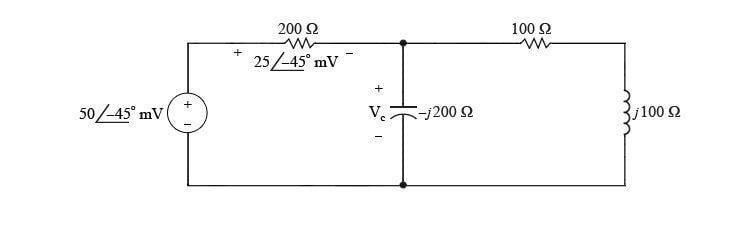

Is this the right way to find Zeq for parallel circuit

Vc=Vsource*Zeq/(200+Zeq)
Is this the correct way to get Zeq
100Ω and inductor as series . so we
100+j100 parallel with the capacitor. which is -j100
so we use the formula Z1 + Z2//Z3
which we get 400
Is this correct
Also how do we multiply the Vsource value ?

pokie_panda said:
[PLAIN]http://www.flickr.com/photos/84781786@N03/8687383259/in/photostream/
100+j100 parallel with the capacitor. which is -j100 \leftarrow should be -j200?
which we get 400
Is this correct
Your description is a bit hard to follow, but it looks like you've got the right procedure. Your result has the correct magnitude, but lacks the appropriate units (that would lose you marks if submitted that way!).
Multiply the Vsource? For what purpose?
I ended up getting the correct solution , thanks for your help
