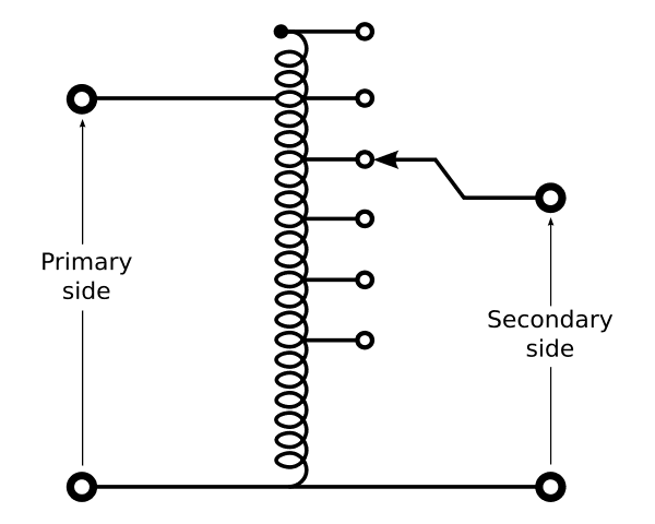

Perhaps the ultimate low leakage is in the autotransformer design, where the primary and secondary share the same coil.
