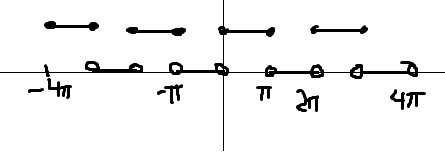

now I'm guessing you can sketch it no worries... what is the period? this will tell you the Fourier components to use. If the function were odd or even about the expansion point, it may save you time as you will only need to consider sin or cos terms

no the problem says sketch f(x)
i think the period would be root 10 or something?
amplitiude has something to do with the A and B i think...
edit: oh, well I am not sure how to graph that. i can do them separately lol (2, 2/pi sinx, 2/pi sin3x) but not together..
hang on sketching as in part a? I've done that.
part b i think I've done it.
