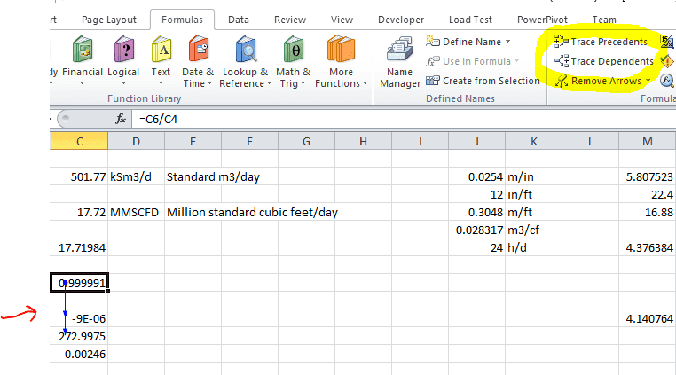

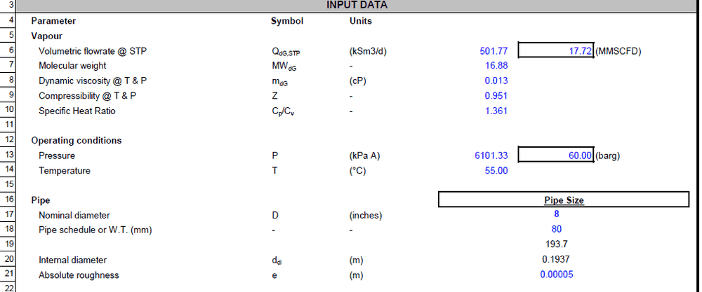

To begin with input sheet line 1:
STP
Standard temperature and pressure (STP) is usually defined as being at 0°C (273.15 K) and 1013.25 hPa (1 atm). However, standard temperature may also be specified as 20 °C or 25 °C. Sometimes these reference conditions may also be referred to as normal temperature and pressure (NTP). Special industrial branches may even have their own definitions, e.g. the gas industry may reference flow volume to a temperature of 70 °F.
So you want to check which is which for your case.
MMSCFD and kSm3/d is easy: 1 SCFD = (12*0.0254)3 m3/d
(This factor should be in one of the two cells, probably in the kSm3/d one)
(Provided the standard states are the same -- they are in your example)​
Standard cubic feet are already defined poorly
A converter comes close: when I use this one , 17.72 in 5 decimals yields 500.63 kSm3/d​
so 0.2% off for some reason -- different but close standard ?​
Next : MW, molweight is 16.88 so mainly CH4 (as opposed to 19.5 for natural gas)
No idea what the dG stands for (@Chestermiller ?)You'll have to find out how the viscosity, Z and Cp/Cv are calculated (with a formula in the cell or with a VBA function call).
In case of VBA (which I would expect): press alt-F11 and search for the function name. Welcome to the powerful world of VBA.​
With 61 bar and 55 ##^\circ##C you are past the critical T and p of methane
Then come the pipe parameters: I can't find a wall thickness of (219.08 - 197.3)/2 = 10.89 mm here, but I suppose the 197.3 mm is what you need and can trust. (I would expect 1/2 inch wall thickness, actually).
And roughness, an optimistic 0.05 mm.

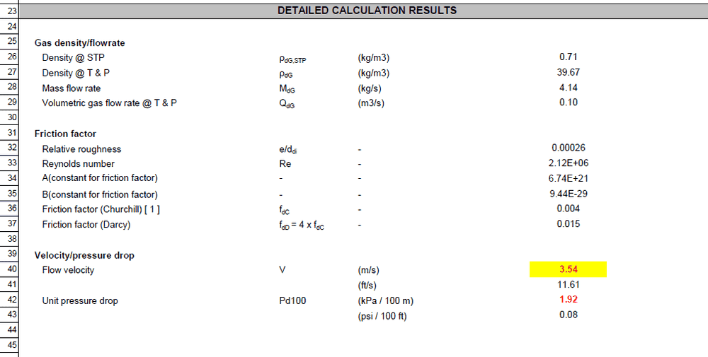

We continue with output sheet line 1:
STP density is a lookup or again VBA
(here it says for methane
Density, gas at STP; 32°F/0°C 1 atm44.7mol/m30.7168kg/m3
T&P density may come from the gas law with a formula using Z, or again through VBA.
Mass flow is straightforward:
STP volume flow 501.77 kSm3/d * 1000 /(24 h/d)/(3600 s/h) * 0.71 kg/m3 = 4.12 kg/s
(why he gets 4.14 I don't know. 0.713 kg/m3 ?)
Then Q in m3/s from: mass flow / T&P density= 4.14/39.67 = 0.104 m3/s
And I would get a velocity of 0.104 / (¼π 0.19732) = 3.41 m/s, but he gets 3.54 !?
We skipped over the friction factor that follows from this calculation: Churchill , Darcy
The resulting pressure drop of 1.92 kPa (0.02 Bar) per 100 m isn't all that much compared to the 61 Bar (I suppose the contraction from 18" to 8" isn't at hundreds of km from the delivery points ?)

I think this author using 4 decimal places during his calculation but in the data sheet he only stated 2 decimal places caused you didnt get the same answer as him
I think there is misunderstanding here. The main parameter that i want to calculate is volumetric flow rate at STP. I don't know why the author place volumetric flow rate at the input column, maybe as data input to the pipeline. Anyway i have done the calculation
For mass flow rate
A = π r2
ρ at T&P = 39.67 kg/m3
ṁ = ρ A v
= 39.67 kg/m3 x π (0.096852 x 3.54 m/s
= 4.14 kg/s
However I am fail to calculate density at T&P. The value of the density 39.67 kg/m3 is from the spreasheet.
By combining ρ =m/v with v = nRTZ/P where n=m/Mw i get ρ = P x Mw / RTZ
P = 60 bar = 59.5124 atm, R= 8.2057x10-5
ρ = P x Mw / RTZ
= (59.5124 atm x 16.88 g/mol) / (8.2057x10-5 m3atm/mol.K x 328.15K x 0.951)
= 39.03 kg/m3
where he get ρ = 39.67 kg/m3
I think the formula is right where it has involved ideal gas law. Therefore, what is the reason i don't get the same answer as author? Is it because the formula is wrong or the decimal places the author used?
For volumetric flowrate
Q at T&P = ṁ/ρ at T&P
= 4.14 kg/s / 39.67 kg/m3
= 0.10 m3/s
Q at STP= ṁ/ρ at STP
= 4.14 kg/s / 0.71 kg/m3
= 5.8309 m3/s
= 503.80 m3/d
If i use ρ = 0.713
= 4.14 kg/s / 0.713 kg/m3
= 5.8065 m3/s
= 501.67 km3/d
where the Q at STP he get is 501. 77 ksm3/d

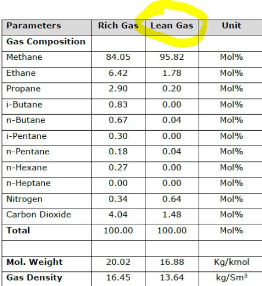

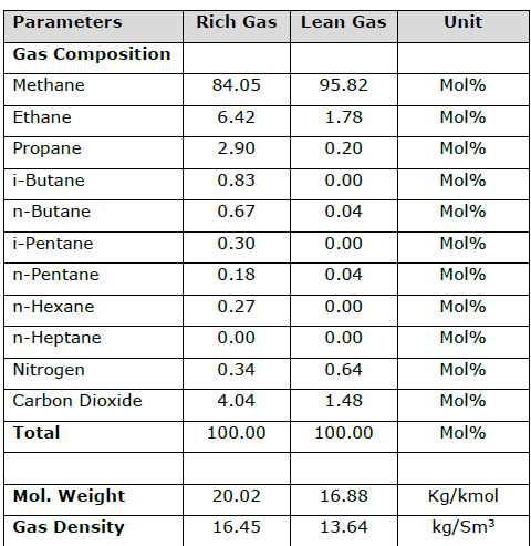

I have settled all the calculation in the spreadsheet except for compressibilty factor and specific heat ratio.
I want to ask about VBA. Is the VBA contain module that can calculate compressibility factor and specific heat ratio or i have to google the VBA code from google? I have do some google and copy the VBA spreadsheet (Brill-Begs correlation http://excelcalculations.blogspot.com/2011/08/compressibility-factor-natural-gas.html and Hall and Yarborough https://topdogengineer.com/coding-the-hall-and-yarborough-z-factor-correlation/) but it seems I can't get the value. The closest I get is from the online calculator https://checalc.com/solved/gasVisc.html 0.95830 instead of 0.951.
As for specific heat ratio, for the lean gas cp/cv I get the value 0.951 but as i want to calculate for the rich gas, i get 0.951 instead of 0.932. It seems that Z value only change as the temperature and pressure change, the change of molecular weight will not change the Z value. Wrong spreadsheet i guess as it use the methane properties https://www.academia.edu/31217573/Heat_Transfer_Excel_Calculations_1?auto=downloadAs in the attachment is the composition of the natural gas. In my case for the lean gas.
?? You posted a composition. Did you have that all the time, leaving us guessing ?

Yes. I have the composition. I am sorry to leave your guessing. I think this information is not required as the spreadsheet contain the molecular weight
The composition can not follow from the molecular weight. Conclusion: Molecular weight is NOT an input, in spite of its appearance on the sheet INPUT DATA . What formula is in that cell ?
And: do you believe the composition sheet when it says Gas Density 13.64 kg/Sm3 ?
Compresssibility follows from T, P and composition. I strongly suspect the cell containing a value 0.951 on the sheet INPUT DATA is also NOT an input. What formula is in that cell ?

Move the cursor to that cell and click to make it the active cell. Does it contain a value or does it contain a formula ? like
Amirul96 said:
Is it in excel?
Unfortunately, I don't have the excel spreadhseet. It is in the form of pdf, not in xls form.
